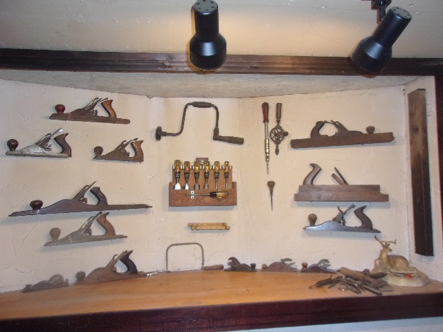

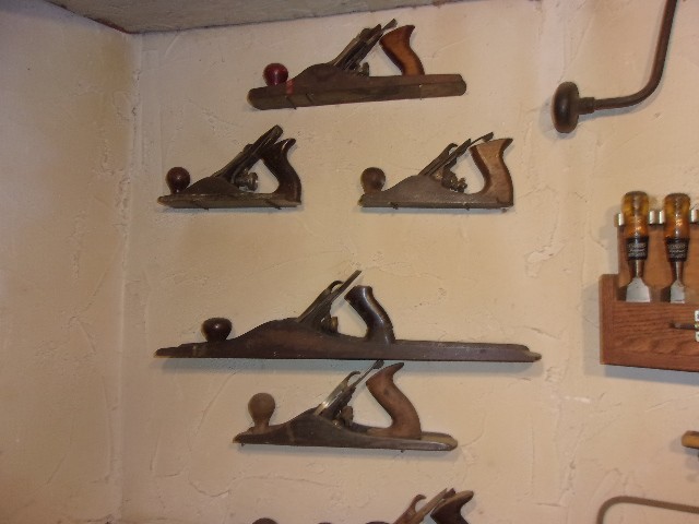

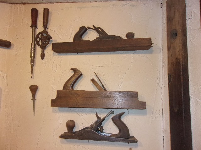

          This got me going,I have a number of stanley but I have many with no maker marks.
