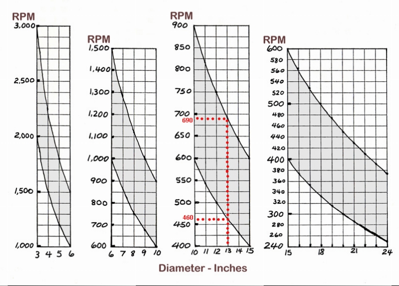

    Is there a chart or generalized opinion of what is a safe speed for particular diameter? I know that once roughed turned and balance is achieved, the speed can be increased, but rough just mounted blanks are outright dangerous as speed increases.
    Opinions and wisdom on the speed vs diameter relationship?

      Check out this website:
      http://www.docgreenwoodturner.com/lathespeed.html
      I've also attached the graph from that website.
      I try to get the blanks as round as possible at the bandsaw before mounting on the lathe, this helps some. I haven't gone beyond 13inch blank start size on the HF (started outboard, on faceplate), and final turned size was a hair under 12 inches (turned inboard after completing outside, for hollowing.) I would not try this with non-round or severely imbalanced blanks of this size on the 34706. If I get the itch to turn bigger, I've got the G0766 on my radar.

        Hank, thanks for asking the question and Bill thanks for that chart and link. I have my first bowl blank sitting on my band saw after rough cutting it round, just waiting for me to find the time to ruin it on my lathe 😃.

          The charts look reasonable and are probably a good guide, maybe a little on the slow side but better safe than sorry. It's really one of those things that depends on your comfort level and equipment. Best advice is don't turn faster than your comfort level.

              THANKS Bill! I had to yell that. It is a GOOD yell! That is THE information for which I was looking. This is very helpful.
