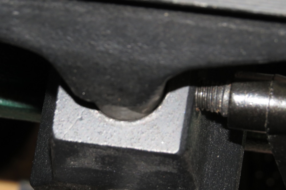

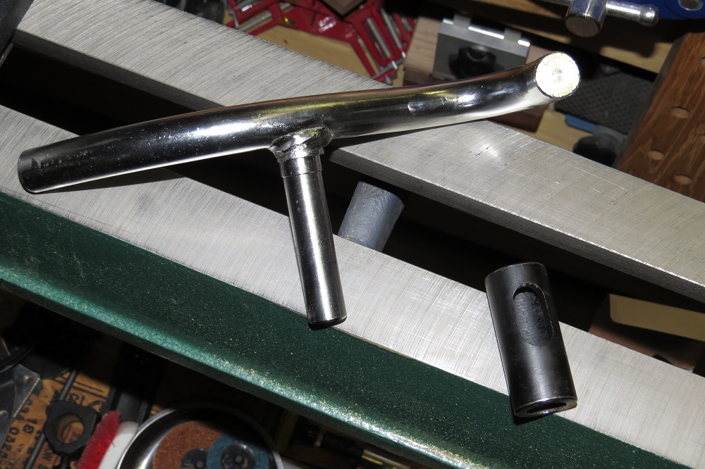

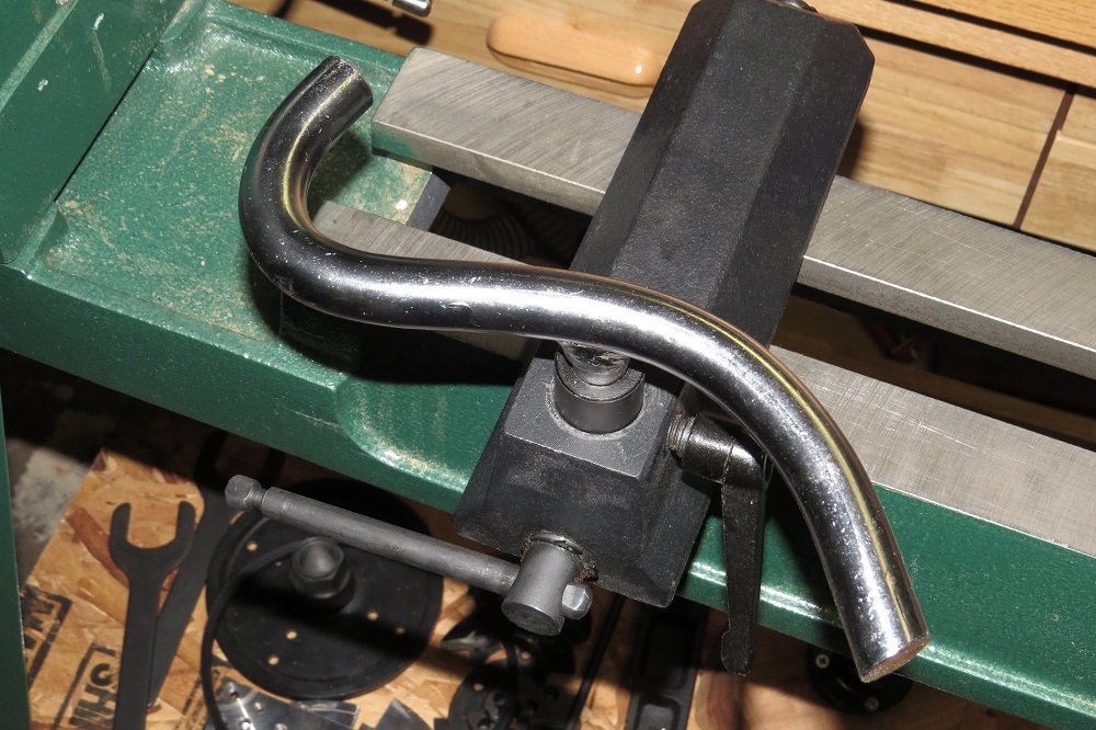

        More good news. Tonight I spent a few minutes running the pink grinding bit from my HF die grinder set (because it fit) in my drill up and down through the 25mm tool post hole in the banjo - and presto! I now have a 1" hole in the banjo. So I can now use rests with 1" posts, as well as this 5/8" to 1" adapter (PSI, $11) so I can use all my 5/8" posted rests, including this curved rest for bowl turning that is on clearance at PSI which I picked up a little while back (was $20, now $6).
          Here are some photos - the first showing the acceptable fit of the stock 25mm tool post into the resized 1" banjo hole, then the new curved rest with post adapter separate, and then seated in the banjo. That curved rest is quite solid.
