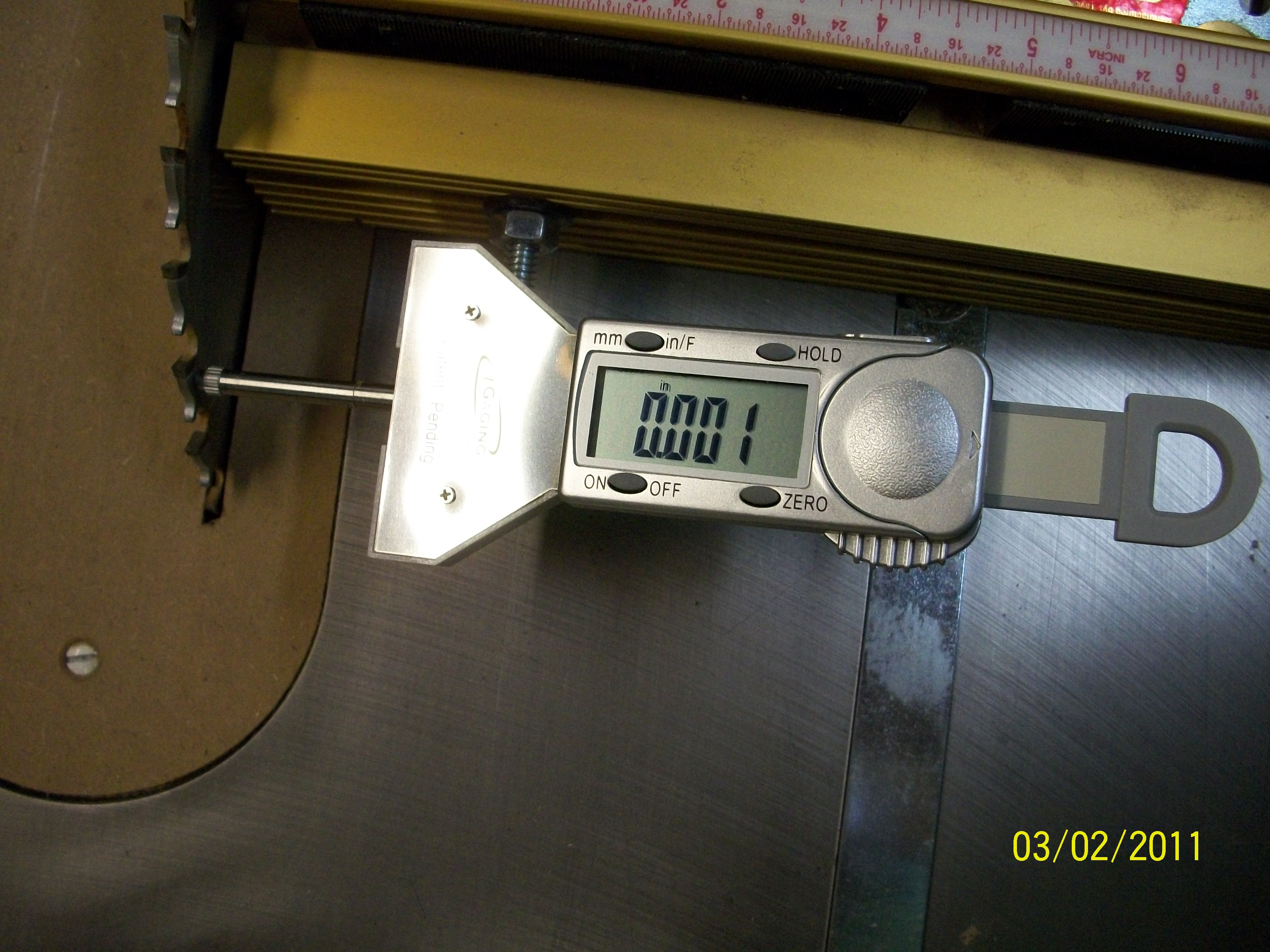

        +1. never saw the need for one of those. your miter gauge and a $10 dial gauge from harbor freight are as sophisticated as you need to be. proper alignment is possible using much simpler methods, but a dial gauge removes a bit of any trial and error.

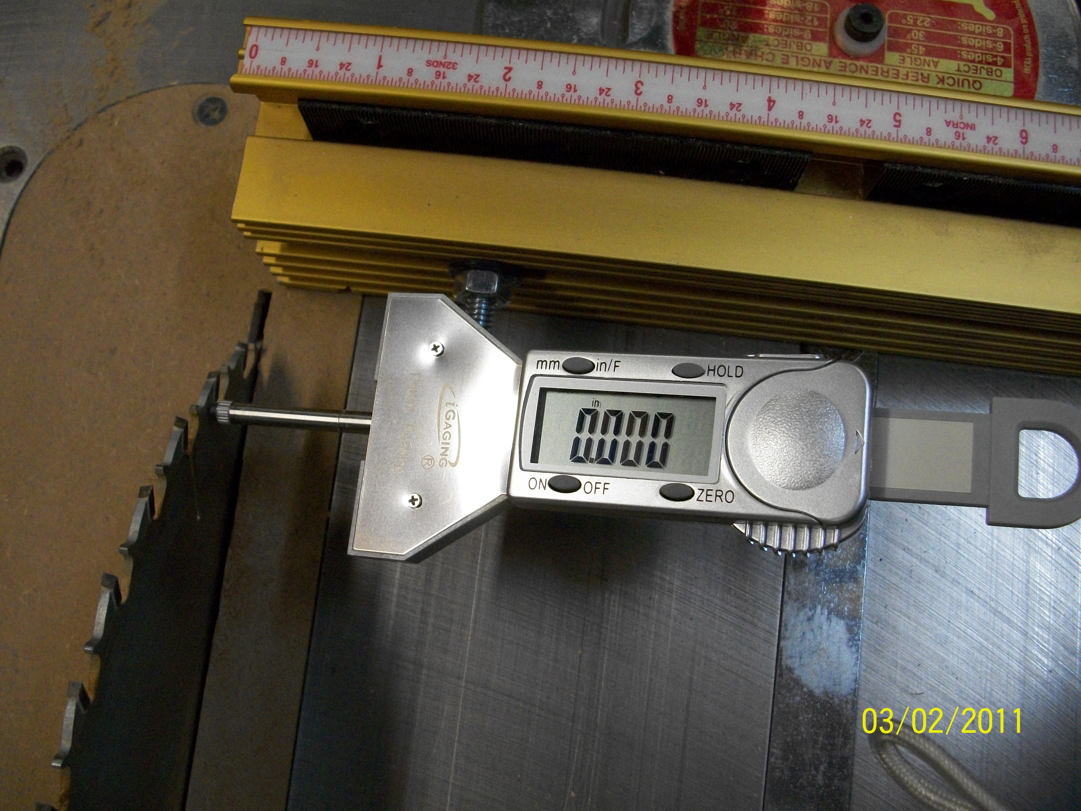

            try getting your miter gauge and set up a dial gauge like this. works quite well. yes, i used the same blade tooth for both measurements.

              Ordered a digita dial today - AMAZON - will report back when I see how it works.

                eliminate any "slop" the miter bar might have in the slot. then square the miter gauge to the blade. then check your blade alignment relative to the miter slot as shown in my pics above (use same tooth on both ends of blade). keep miter gauge in same slot and check fence alignment the same way. good luck.

                  okay - the miter is square to the blade - the gauge help tons. Now a second issue. I will post on the BT300 question board in case there is someone else with similar issues. Thanks Toolguy!
