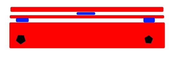

          That must be it. I Googled Springboard jigs and what I got was similar but different. Below is a rough drawing (jpeg) that I made up that shows the outline.
          The blue are small pieces that hold the straight pieces away and allow for flex yet good pressure for the length of the board. The black are knobs that tighten it to the miter slots.
            Don't think I have seen that idea before. Do the knkobs ride in slots to allow you to adjust the distance/pressure?
            I remember some that Lee made with a strip of plexiglass to provide the pressure.
              • 8793
              The knobs just tighten it in the miter slot and hold the board there.
              It is important that the outer board is about 1/2 to 5/8 in thick (front to back) so that it does not flex. The middle board should be about 3/8 in and it is the one that takes the flex. It does provide equal pressure over a longer area than featherboards do.
