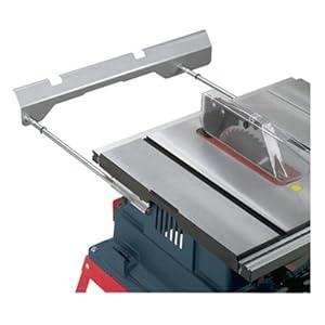

    Has anybody attempted (or succeeded!) adapting the Bosch TS1002 outfeed support to the BT3100?
    See: http://www.amazon.com/Bosch-TS1002-O...neral_recs_114
    I keep my BT3100 on a very mobile base (the Bosch gravity-rise stand), and this looks like it would be simpler and faster than setting-up a separate stand for small jobs. It also could supplement a separate stand for bigger jobs and minimize droop.
    If any of you have this outfeed support, I'd just need two dimensions to know if this is feasible:
    1) The distance from the top of the brackets to the top of the rear outfeed (IOW, how thick is the 4100 top)
    2) The distance between the two mounting bracket holes (the long dimension between rails, *not* the short dimension within one bracket).
    I'm sure I could make something equivalent, but probably not for less than $30...
    Thanks!

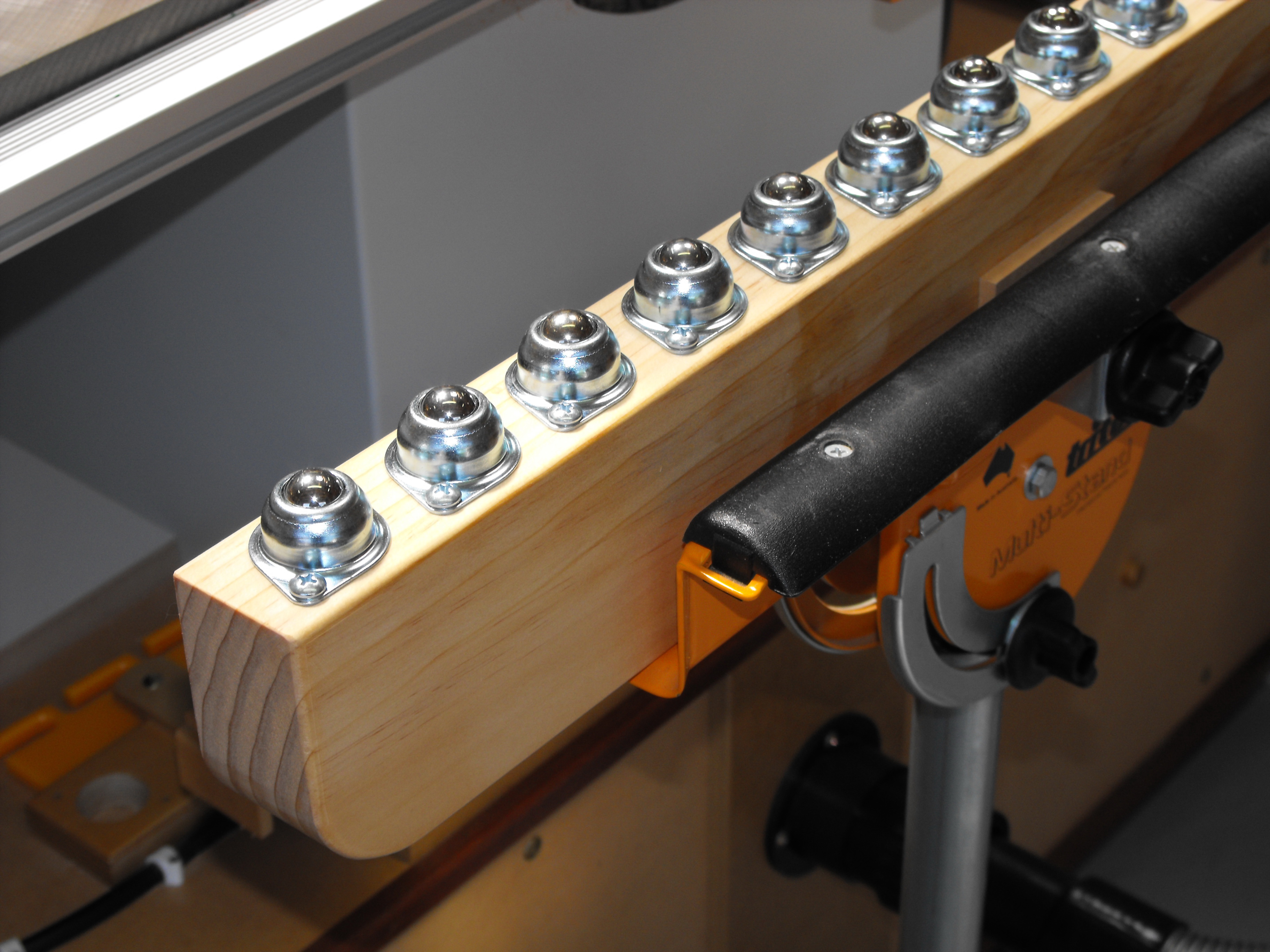

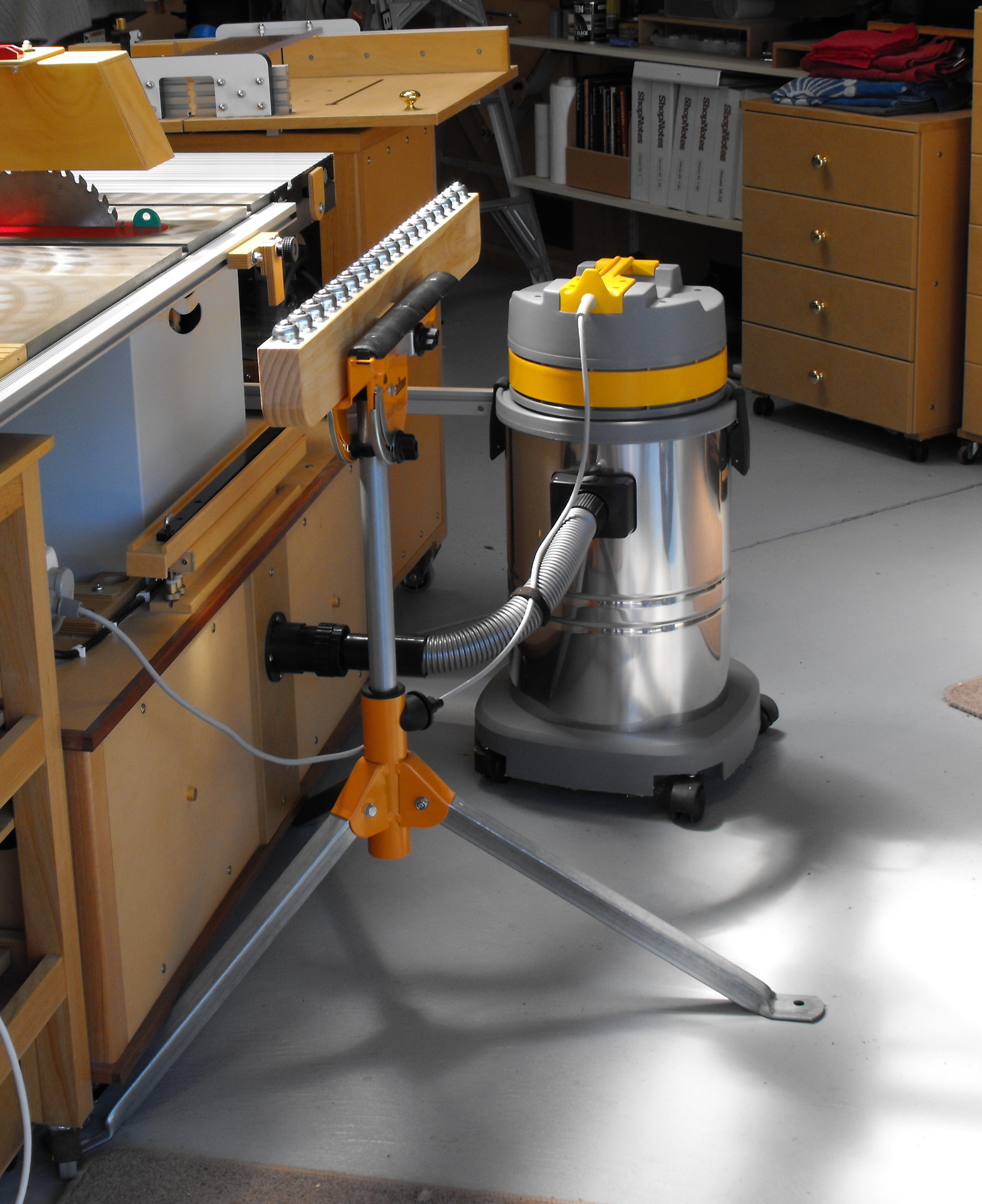

      • RodKirby
        • 3136
        • Mao Shan TSC-10RAS
        This one does it for me

        Downunder ... 1" = 25.4mm

            I was able to get the dimensions from a Bosch T4100:
            1) 1 3/4" table thickness (surface to end of threaded boss)
            2) 23" width between mounting holes for sleeves
            3) 5" between mounting holes on each sleeve
            So this is - shockingly - not a drop-in fit to the BT3100. But it may be pretty easy to adapt.

            Your suggestion inspired me to check for an owners manual online. Viola! Link
            This snip from the PDF (Link) shows that the rod ends are bolted to the outfeed support (instead of welded), so the width should be easy to customize with one drilled hole. I'm also thinking about bolting the sleeves to the side of the BT's case (instead of under the table). I think this would simplify mounting and be very sturdy.
            This might actually work!
