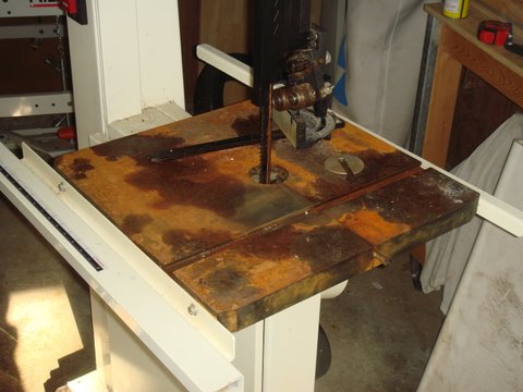

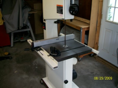

        you can use wd40, but topsaver and the same scotch brite pad (rough one forst, than a finer grade) works better. here are the before and after pics of my band saw. the after pic used elbow grease and topsaver with course and fine scotch brite pads. the top was so rusty i had to use wd40 and a tapping block and hammer to remove the miter gauge from the miter slot. once the rust is removed, wax liberally with a paste wax (no car wax). once cleaned and waxed, keep the top covered with a blanket, piece of masonite or plywood, a sheet, almost anyhting and it will greatly reduce the recurrence of rust.
