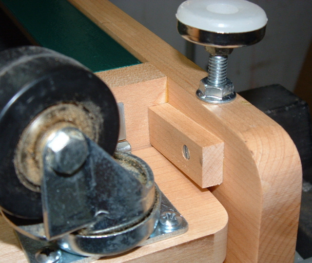

    2. Also an easy fix by adding stop blocks under the caster plate. The blocks are set at an angle just below the lowest point the lever will push the plate down. I just glued them in place and then added a single screw for reenforcement.
Name:	Castor Plate Stop.jpg

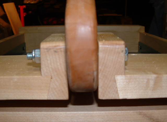

    3. The most complicated solution. I redesigned the lift lever so it sits perpendicular to the caster plate and pivots with a step-down motion. (With the MDF prototype of my modifications attached to my BT3 and the wife was able to lift it onto the casters with no problem. http://www.bt3central.com/showthread...hlight=jointer )
    The pivot block is made from 2 dovetailed pieces set in the center of the top end plate with a 7/8" opening between them. The rear block only serves as a stop for the lever in the up position. It is face glued to the pivot blocks and the top plate. The 'axle' is a 1/4" x 3" bolt with flat washers on the outside and a nylon lock nut.
Name:	Lift Lever Pivot.jpg

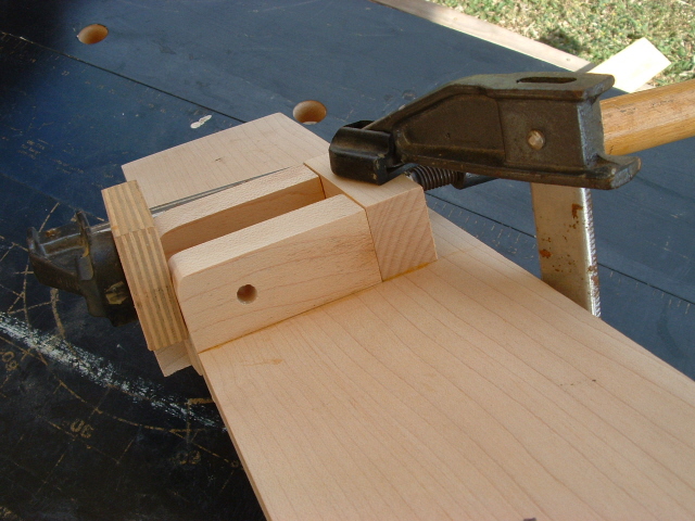

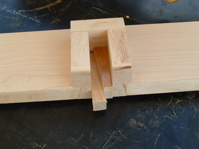

    Glue up was fairly simple. I cut a pair of wedges to drive in between the dove tails and then used a pair of clamps for the rear block.
Name:	Dovetail Glue Wedges.jpg
Name:	Lever Pivot Glue Up.jpg

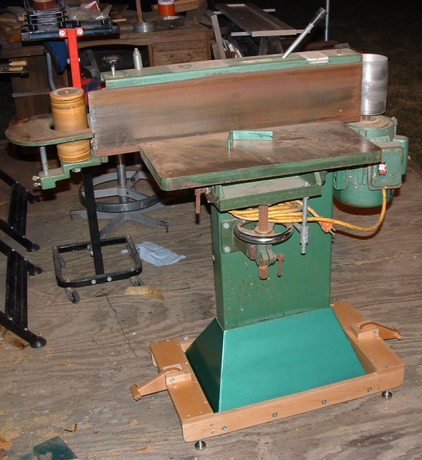

    The completed base under the edge sander with the levers in the down/lifted position.

        JR, I felt the dovetails were needed to provide vertical strength. Didn't have looks in mind.

            Did you try a rabbet for #3 & find it to not be adequate? The dovetail makes sense, I'm just curious if you tried something else.
            Ok, you answered my question while I was typing.

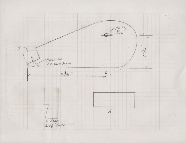

              Did a quick template page for the lever with some dimesions added in for anyone interested. You would need to blow it up and print full size (1/4" grid) or redraw it.
              I have it full size in my computer but it is to large to post. I will email it to anyone that wants it. Just PM me with your email address.
