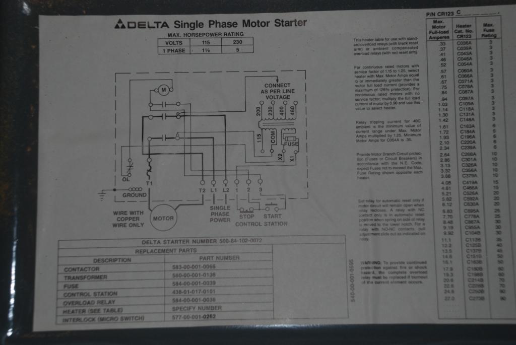

    From conversations back and forth with the guy, it appears that the saw is little used and is 7 years old or so. It is single phase, 220 volts. Attached is a picture of the panel cover.
    He didn't offer up the model number and I am not familiar enough with Delta unisaws to know for certain from the pictures whether it is a true unisaw or a hybrid. Any insight would be greatly appreciated.

      one more thing. looking at the scematic, that appears to be a motor that will run on 110v. and if i am reading the specs correctly, it seems to be 1.5hp @ 110v and 5hp @220v. just wanted to point that out.
