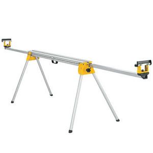

      I've had my DW713 for about five years and have never had any trouble with it. Very well made just like everything else I've owned from DeWalt. I use mine with there DW723 portable stand and find it very convenient.
