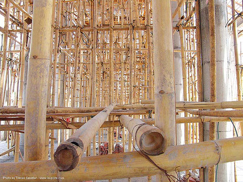

                    I would have thought you would go for something like this:
                    From: http://www.loupiote.com/photos/18321405.shtml
                    Or is bamboo not that available in your area?
                      Funny, somebody over on FHB just asked the same thing. Actually, there's lots of bamboo here, but I don't think I've ever seen it used in scaffolding;guess it's just a difference in cultures (it's used pretty widely in China and SE Asia). Thirty years ago I used to see lots of wooden pole scaffolding, and it's still used for relatively small jobs (or by smaller contractors); they even have special wires and tools for bending it around the poles, but almost everywhere they're now using site-built scaffolding of steel pipe joined with connectors. Here's some of the wood pole stuff:

                        I imagine in just the skill needed it's less expensive to put up pipe scaffolding than the pole or bamboo, but it sure is a lot less interesting to look at.
                        I find it interesting the different solutions to the same problem that different people come up with. Even the steel pipe scaffolding is not like what you see in the states (at least I haven't see it like that expect in a shipyard) where we tend to use modular units to build the scaffold. It will be interesting to hear what your neighbors think of what you come up with to work off of.
                        Bill, over here on the other side of the bigger pond
