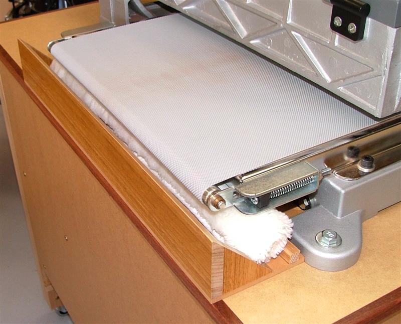

    beautifully done. just simply beautifully done! BTW, what type of conveyor belt are you using. the one in the photo does not look like the OEM that's currently on mine. thanks.

      This is an "Oz" machine - I believe a badged Ryobi.
      Re your PM
      - standard OEM belt
      - yes drilled-tapped
      - 1/4-20 studded knobs into t-nuts

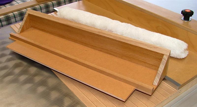

      Some more pics...
ID:	785117Click image for larger version
      Downunder ... 1" = 25.4mm

        is yours a steel city 55210? on the stabilizer, are the base and the material mounted to drum head 3/4", while the vertical slotted piece is 1/2". thanks. again, nice execution.
          No it's a Carba-tec. Yes on the Marine ply I used
