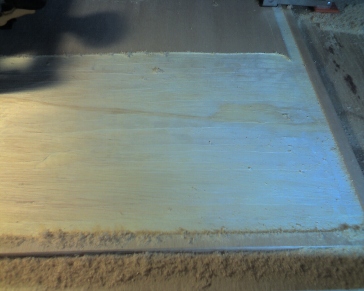

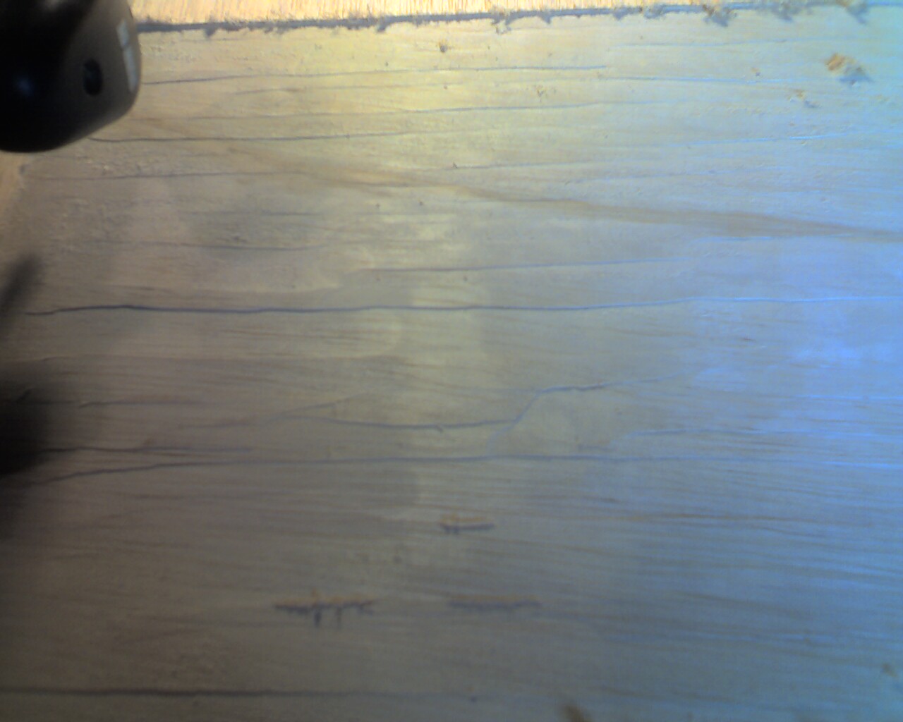

                    Ok, here goes with the interim pictures. From an elderly Treo, so not so clear. And, BTW, this is NOT your father's, nor anybody's, birch ply. It is in fact a bright white-colored pine that I found attractive, with a nifty grain. Apologies for the mistake, but it really appealed to me and, oddly, got the project going, see below. N E way.
                    The first is partway through. The second shows the sort of "beach at low tide" effect achieved by not being able to hold the router absolutely level.
                    Obviously in progress. But I DID get a nice, wood "groove" (as contrasted with what I call the "land", the surface as manufactured) which I probably can smooth.
