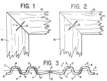

    Have you seen these from Lamello? Do you think that they are any more than a different way to use bisquits, dowels and take down mechanisms?

    It's a high priced fastener. It's a version of a corrugated fastener that's been used for as long as I can remember. I use an air gun for the fastener but it can be hammered in. The principle is that the design pulls two parts together.

      Bold added by me. I think you are partly correct in that it is somewhat like a corrugated fastener however corrugated fasteners are designed to hold parts together not draw them together as the Lamello device. I think the intended market is quite different between the two also.

        The corrugated fasteners I use are designed by the shape of the cut to pull parts together, not just hold, as I stated. As they are driven in you can see the parts tighten together.

          Then perhaps you should have linked to them The ones you linked to are exactly like the cheap ones I've used and found used in poorly made window screens and they only hold, and that is only if they do not split the wood. By the way I was not aware that they made them with tapered ridges, do now.

                Yeah, whatever Ray! The fact of the matter is Cabinetman linked to a fastener that does not do as he suggests, it simply just holds two pieces together. The vendor whose site Cman links to also gives no indication that they are either of the two types. I edited in that I was unaware of there being more than one type of corrugated fastener. Did I learn that from what Cman posted, uhhh nope I had to research it myself. Cman could have found a better link.
                  I read this post as "the principle of the design" being referred to was the Lamello fastener, the subject of the thread, not the "version of" link to the corrugated fastner.
                  The clue is in the sentence "used for as long as I can remember" - which clearly does NOT apply to the Lamello fasteners discussed, but does apply to the corrugated ones.

                      Not to distract from the previous banter... but, I haven't seen them. They don't look too cheap though. Rockler has them for $5 an 8-pack. They added some directional ridges to draw the pieces togeather. I wouldn't use them.

                            I'm almost reluctant to get on this but I think it might help. in the picture blow of a high end corrugated fasteneryou will see that the center has a bend between 9 and 13 this bend angles the main corrugations out from the center. as they are driven in this bend straightens out and draws in the joint together.
                            Part of the problem is that the cheapies that you can buy don't have the center bend and only hold a joint, not draw it as was commented on. The style above of corrugated fastener is used in the air driven fasteners. the high priced fasteners are marketed and work the same.
                            If you need a lot of them just buy the ones for the gun and pop them apart and drive them in.?????? should work.
