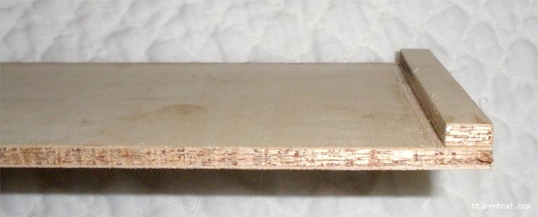

    In a recent thread, I made a note of a mini-sawboard I made for squarely cross cutting boards. Ed and Twistsol posted a comment, so I decided to give the Squared Mini-Sawboard its own thread here.
    Originally, I used a speed square in crosscutting with a circular saw, but I hated to do the precise measuring required for perfect alignment with the cutting line on the circular saw. So I first made a sawboard like spacer and butted it up against the speed square. This gave me easy and perfect alignment. Then I misplaced my 12 in speed square. I did have my spacer, so I decided to add an edge to it, and then I added a small cross piece glued to the bottom - carefully squared to make it align perfectly.
    Basically, it is a sawboard on a mini-scale for crosscutting 12 in wide and narrower boards. If I were starting from scratch again, I would make the back board on the left side - several inches wider to allow clamping from that. As it is now, I place the mini sawboard in place and use another backer board against the sawboard and clamp the backer board. I like the small size because it doesn't take a lot of space and can be stored in a quick to reach place.
    Very simple and very handy for cross cutting accurately with a circular saw.

        Basically with a square, you have to line the saw up first and then adjust the square and then clamp it. You can't just start with the square first unless you account for and use the measurements from the blade to the edge of the shoe. Lots of figureing and adjusting with the clamping everything into position for both sides of the board to be cut. With a sawboard itself, that is eliminated. The part of the sawboard that the saw sets on and slides on - the edge is originally cut off by the blade itself, leaving a perfect one side Zero Clearance line for the cut.

        The edge of the sawboard lies precisely where the blade will be and therefore the precise cutoff can be determined from one end to the other visually. When on a T square or against a speed square, it is common for the far side to be off by 1/16 inch and you don't know it until you get there. But with a sawboard, you know before you begin where the finish cut will be.
        Click here to see the full advantage and the principle behind it. One thing that he does not show on there is the building of the saw board. Originally the bottom where the shoe slides upon is much wider. But the edge of the bottom piece that acts as the slide - is cut with shoe against the 2nd level piece, assuring that the blade is aligned with the edge all the way over.
        What I did was just make a small one for crosscutting 1x 12s. Most pictures of sawboards show them being 3 ft, 6 ft or 8. But on mine, I added a "square" to the bottom edge.
        For the mini saw board, I made it to crosscut some 1x12s by 8 ft for the carcass of a bookcase that I am still working on.

                  We are kinda getting off the original point of the sawboard. Basically what I did was add a "lip" to the bottom side of the mini sawboard so that it was self squaring, kinda like the lip on a speed square. The pencil mark and line are already there, so it is "good to go" quickly.
                  I add a backer board for the "clamp down" to keep it from moving. If I had made it slightly larger to begin with, I could have clamped the mini-sawboard itself.

                    I use a sawboard for cutting sheet goods. But I never thought to add the self squaring lip on the bottom. Simple enough, and very effective.
                      Exactly. I'm absolutely going to make one of these (thanks Hank!). Actually, two (one for my battery-powered saw).
                      In fact, I'm going to make several and give them away to friends/relatives that don't have chop saws.
                        Another neat thing about a short sawboard is the ease of making angled crosscuts. I just lay the board over my layout line, clamp, and cut.
