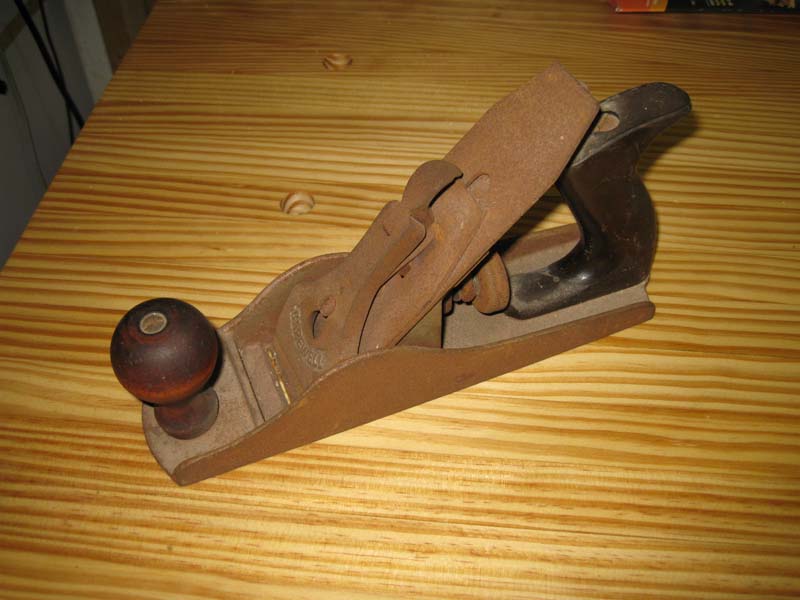

    I found a box in the basement, that had an old Bailey No. 5 Jack plane in it. I have no idea where it came from! My knowledge of planes is very limited, so I need a little help.
    The expectation is that I likely won't put in the time/energy to restore the plane to original condition. It is much more likely that I would put the time in to get it in good working condition. The plane is 14" long, and 2 3/8" wide. I took a few pics of it, and it looks to be in worse shape than it actually is. The rust doesn't look that bad, when viewing the plane itself. The sole is not perfectly flat, so I know that needs to be taken care of. But I don't know the best way to take care of the rest of it. So I need someone to sing the Beetles song, "I want to hold your hand".
    [ATTACH][/ATTACH]

    If it is complete and there are no cracks in the castings then it is not in bad shape. Looks like my No.5 did when I got it and it did not take long to get it in good working condition. There are TONS of resources that can be found with Google to get you started. I would go into more detail but I am in NC on vacation right now and if I spend much time on the computer LOML is going to get cranky.
    • Knottscott
      • 3815
      • Rochester, NY.
      • 2008 Shop Fox W1677
      It looks to be a type 13 to me (1925 - 1928). It looks a bit rough but intact from what I can tell. It should be well worth restoring. I refurbed a 1918 Bedrock 605 last year that came out pretty well. Mine was fairly rusty so I sprayed it down with rust remover, wire brushed it, flattened it with some 150 grit sandpaper, sanded down the wood handles, put on a couple of coats of enamal, and sharpened it...basically just a couple of hours of elbow grease. It came out OK.
      Yours should make a great user!

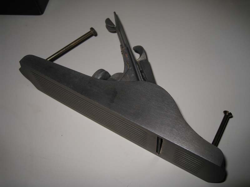

          Check here for the best process to remove/neutralize rust. IO used the same process to clean my 8" jointer.
          http://home-and-garden.webshots.com/...23043839Vtdorw
          The album goes into full rehab with Japaning but you could also tape off the machined areas and use black enamel.

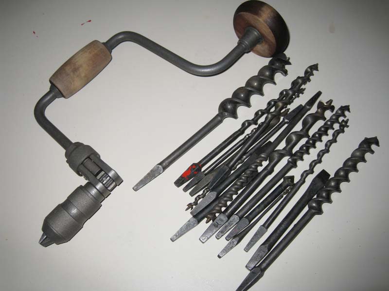

            You might check out the EvapO-rust product. I picked up a gallon from HF a while back and today was the first time I used it. It has worked wonders on a bit brace and a try square. They were rusted more then your #5. It got the light rust on my chisels and bits for the brace off in no time.

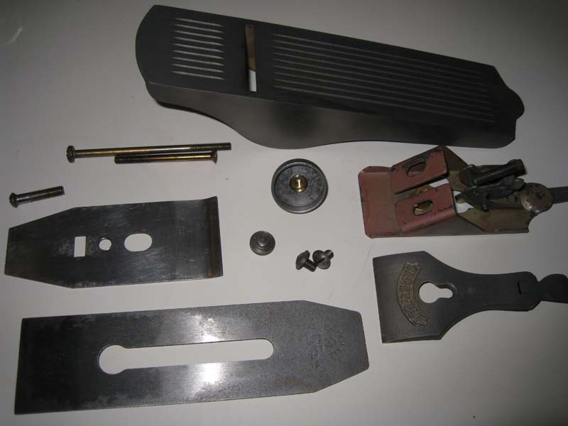

              Don, how long does it normally take for the electrolysis to work? I'm sure the time varies, but just a ball park estimate for a not too badly rusted plane. Your results are absolutely stunning!
                Ed, the #7 I documented was in about the shape yours appears to be in. If memory serves me right, it spent about 3-4 hours in the bath.
                Make sure the positive lead from the battery charger to the anode is out of the solution. The process will eat away at the anode and the thin metal of the clip doesn't last long. (DAMHIKT) I welded my anodes together, but a piece wire screwed to the metal will work just as well. The negative lead is safe and will come out clean.
                  One more question, Don. I've seen electrolysis mentioned before, but I don't remember them putting any type of powder or anything on the rusted piece. Is that necessary? And if so, would baking soda work, by itself? Thanks for the answer. I kind of expected the process to take maybe a couple of days.

                      Below are the results of the evapo-rust product. The bit brace was just as bad as that plane. I let them soak overnight last night. A little work with a brass brush was all the elbow grease used.

                        The key ingrediant is sodium carbonate disolved in the water. I bought it in the pool chemicals section at Lowe's. I would have to look at the can to be sure which, but either PH increasor or decreaser one is 100% sodium carbonate but for a one time job it is also the active ingredient in Arm and Hammer Washing Soda, and cheaper to buy. Baking soda is sodium bicarbonate.
