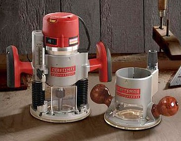

                        Originally posted by LikesWood
                        Is is really a 1617? This and no modifications looks appealing.
                        AFAIK, Sears discontinued their red 1617....it truly was a 1617 with interchangeable parts between the Craftsman and Bosch, but had a different sub-base. You may still find some in stores though. I don't think the current 28084 is the same router, though it gets good reports.
                        Craftsman 1617
Name:	cman 1617.jpeg
                        Bosch 1617
                        Current Craftsman 28084
                        • vaking
                          • Apr 2005
                          • 1428
                          • Montclair, NJ, USA.
                          • Ryobi BT3100-1
                          Sears next to me (NJ) has them and I think you can order online too. It is a close copy of 1617. Different sub-base means it is made to fit "Craftsman" style of sub-base and attachments - that is why it will fit into Craftsman/Ryobi mounting plate with no modifications. It accepts Craftsman style of bushings and attachments but I think it also accepts Bosch style. It comes with dust-collection attachment bosch style for hand-held use. The only thing I am not sure is if the table in the saw is pre-drilled for above-table height adjustment. I know my BT3100 does not have provisions for it. The router has the wrench for above-table adjustment and you might have to make one hole to make this feature work for you.
