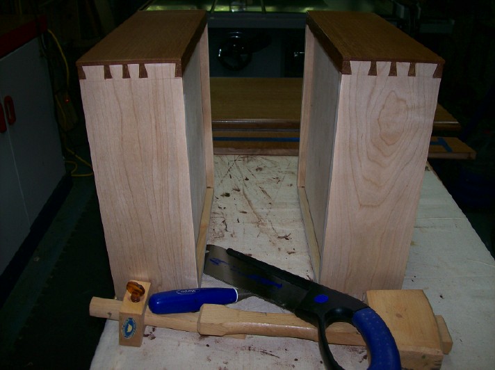

                  In your case here's the jig I suggest and the one I have been using for 38 years. I ran down and took a picture of it just a few minutes ago. It's been used for around 5000 years and works well on through.. blind.. secret miter.. etc. You can use it to space any way you want to as in random. You can use large pin heads or very tiny pin heads and the width and lenght is not a factor at all.
                  Cost around $60 but is very versatile. I cut the two drawers for a fish tank table about two days ago and in finish now. Took about an hour but the good news is their is no production schedule as in a cabinet shop where a newer style jig is almost a must if you found a shop doing high end drawers with DT's which is not likely.
                  Cheap but delivers a true "signature" which can't be duplicated IMO... Clck on picture to enlarge...
                  Good luck...
