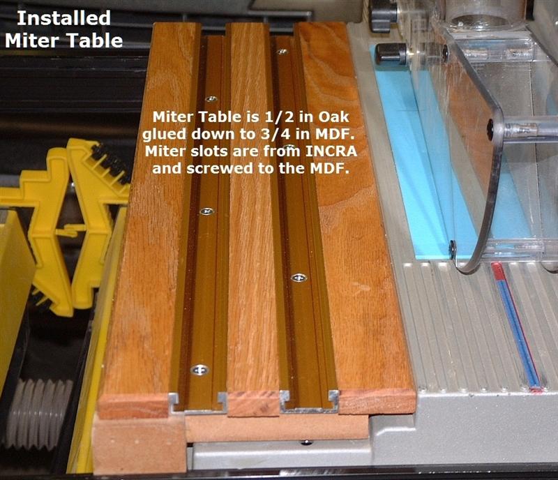

          I agree with both poolhound and melsonO and should have mentioned that in my first post, especially the part about the miter fence "tipping out" if you don't use tracks such as the INCRA version that has real T-slots. Here is a picture of the miter slots I built to accommodate the 1000SE. I almost always use the slot that is farthest away from the blade.
          Regards, Steve
