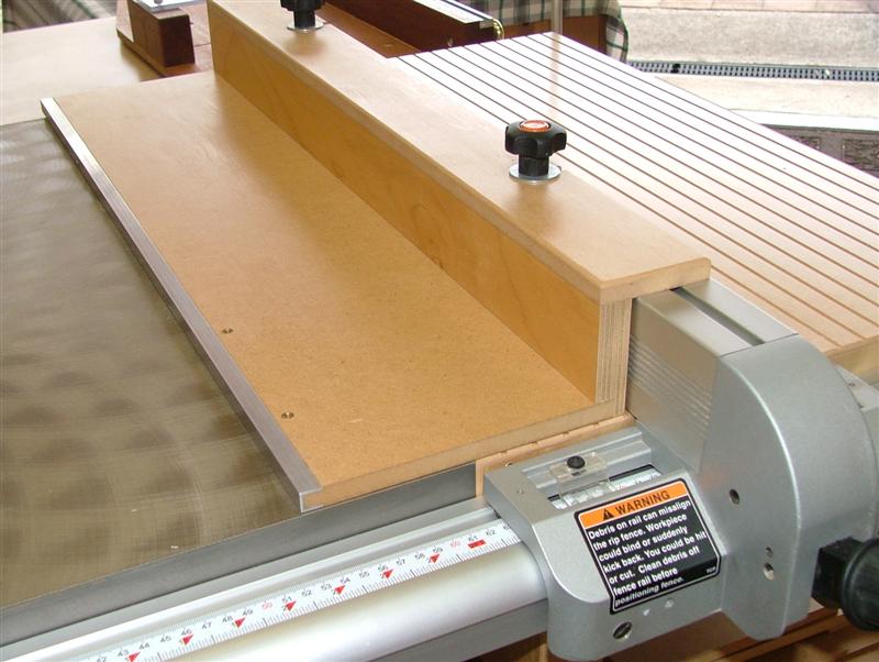

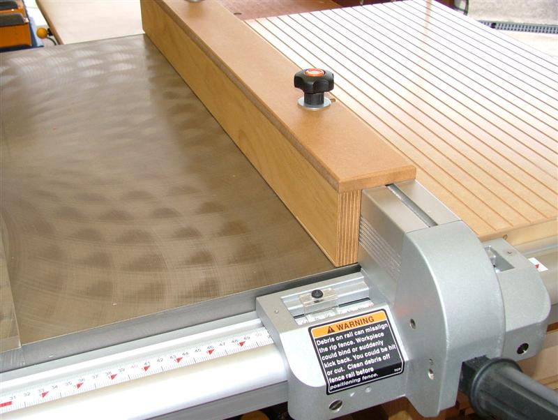

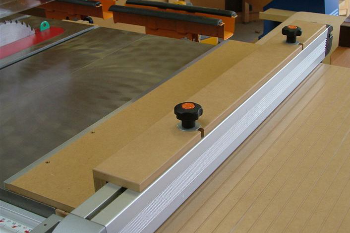

    AT LEAST poly and wax - similar to a router fence - or something like this (aluminum channel)...
    Re your question: A poofteenth (technical term for "just a little")

          My vote is for "C" also. As for any gap, just a very slight bevel to clear the table. To keep thin materials like laminate from sliding under the fence, a strip of hardboard or plywood (1/8" to 1/4") or a larger section just set down on the blade to the fence setting will raise thin materials high enough, and also provide a ZC. A stop mounted on the bottom rear will catch on the saw table and keep it from moving forward.

            Not sure what the profile of the Ridgid fence looks like -- do you have any interest in making the face taller than the the rest? If so, the BB ply is the way to go. And, to answer your question, a couple coats of poly followed by a good waxing will keep your workpieces moving very smoothly.
            Concerning how much space to leave between face and table. One approach is to just make it flush with the existing fence bottom. Or, you could build in a little slop, uh, tolerance, in how it attaches to the fence, then set the height with the whole thing in place on the saw. Let the loosened face sit on some shim material on the table, the shim material being the thickness of the desired clearance, and tighten down.
