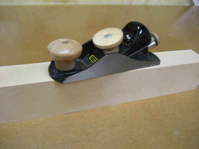

    I bought this Stanley block plane from some hardware store (before there were HD's, but well after Stanley was making cr@p). Somehow (and I can't even remember the first motivation) it occurred to me that a bigger front knob would be helpful. It really does help, though, in that getting a good grasp here allows you to register the toe on the workpiece better when starting a stroke from off the workpiece.
    Adjusting the blade was still a huge PIA, because when you loosen the clamp to adjust, everything gets too loose. So, when you tighten back down, it's a crapshoot whether you've adjusted to where you want. So, I put a big knob on the adjuster, too, and rather than loosening the clamp, I loosen the knob by hand, which is much more controllable, while adjusting the blade.
Name:	Stanley Block.jpg
    That was much better, but still not a home run, so I tried this modification:

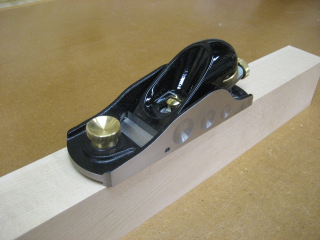

Name:	Veritas LA Block.jpg

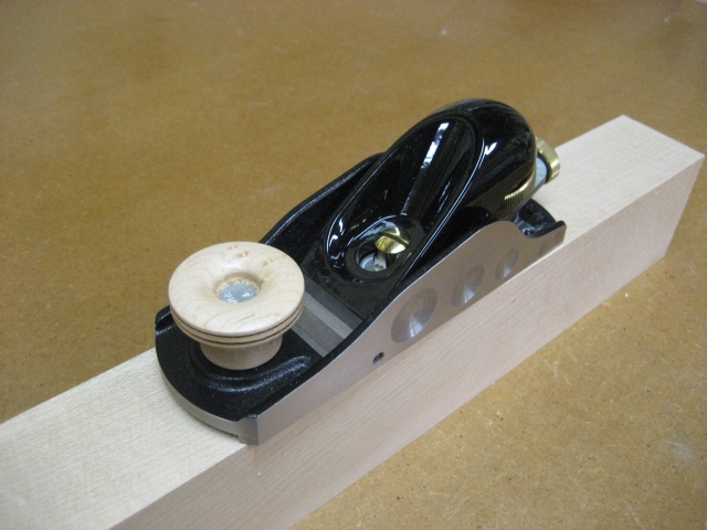

    I call this mod "finally buying a new block plane". The venerable Veritas Low Angle Block Plane. But, I had really become accustomed to the big front knob on the Stanley...so why not?
Name:	Veritas Modded Block.jpg
    I had a really good feeling that the blade adjustment would be way better, based on my Veritas LA Jack, and it did not disappoint. The Stanley will still get used plenty, but mostly just for the dirty work.
