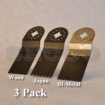

    I found a company ("specialtydiamond") selling set after set of blades, in sets of 3,10 and 15.
    They have 4 varieties: 1 1/8 wood, 2.5 wood, 1 1/8 bi-metal, and 1 1/8 "Japan" toothed.
    They mostly sell 15 packs (5 each of the 1 1/8 wood,bi-metal and Japan). If you wait around, you can get them for $100, but typically they sell for $120 for a set (currently with free shipping).

    You can see from this picture how the mounting hole works on the star-post of the new MM, but in such a way that you can only mount it straight, or 90 degrees left or right.

    The very first thing I did was to put the bi-metal blade on and try to go through some nails.
    I started with some normal roofing nails.
    And while it did eventually cut through the nail, it wasn't fast like the video - it took about 30 seconds to get through each one. And, after going through the nail, the blade still had teeth. Next I tried the most likely thing I would run into with these: a drywall screw.
    Well, that was more than it could take. I spent the next few minutes trying to buzz through it, watching the sparks fly and the teeth round.
    I tried multiple speeds (fast, slow, in between), and the result was the same.
    These blades don't cut nails like they advertise - [sarcasm] color me shocked [/sarcasm] .
    So, $8 down , I moved onto the wood blades.
    I first tried the fine tooth (on some 2x4 pine).
    A funny thing happened to that blade - it was like it wouldn't seat correctly, and was making a funny noise until I turned the speed down. It didn't cut well at all in that mode.
    I removed it and replaced it a few times until it would make a normal sound on high speed - then it cut like crazy.
    Nice fine, precise cuts.
    Next, I tried the Japan blade - this one seated fine and MAN OH MAN does it cut fast.
    The cuts are not as precise, but it seems to cut about twice as fast as the fine blade.
    So... bottom line... these seem to be a fine set of wood blades for the money, but as for the metal cutting... don't count on it.
