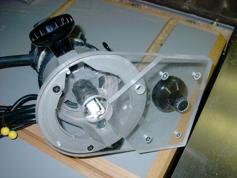

    I've seen several jigs that do what you describe. Here's one. You could accomplish the same thing by clamping a scrap board to the shelf, shimmed out to clear the overhanging part of the edging.
    An offset base on the router helps, too. You can make one yourself, using something like 1/2" Baltic birch plywood, or buy a fancy one from Pat Warner.

      google "flush trim jig" and ya gonna get a gazillion good varieties.
      the one larry posted is also on a sawmill creek thread.
      http://patwarner.com/vertical_trim_subbase.html
      heres one someone there made. (attached)
      an even simpler solution i saw was using a 2x4 the length
      of the shelf,with a 1/4" rabbet/gap along one edge.
      just clamp it flush to the edge banding (mounted vertically)
      heres the book.
      heres one from shopnotes, pdf form..
      one last one, here
      think this is very simplistic too!!
