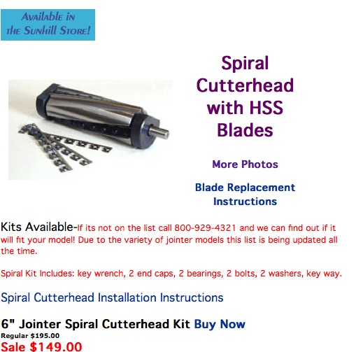

      David,
      A few years ago, I purchased a replacement cutterhead for my 6" Rigid jointer. I got it from a company called Sunhill
      http://sunhillmachinery.com/Spiral%2...Conversion.htm
      It's not the type with a bunch of carbide squares, (see photo)
ID:	783790, its just 3 thin razor type blades. I've used it on stock from Pine to Macassar Ebony and have never had a bad surface. And the best part of it is its price $150.00.
      BTW, I'm still on the orig. set of blades and i've must have run at least 300 BF of hard woods thru the jointer.
      Check it out.
      Bruce

              Opps... the heads I was referring to are the "square jobbies" that Bruce mentioned. I suppose they might be called the helical as I am not familiar with the actual name. But the one's I referred to don't spiral around the head as Bruce mentioned his did. I have not used those so I cannot comment on them.
              Sorry bout that...

                The technical name for the "square jobbies" is a shelix, which is the typical "byrd" cutterhead that is sold for hobbyist machines.

                    David,
                    Bruce,
                    You recommended that I replace my knives on my Ridgid with Sunhill's. I bought it about 3 months ago and still did not have a chance (time) to replace it... can't wait though.

                      Typical Marine!, What are you waiting for. It takes about 1/2 Hr. for most of us. Three hours for Marines, Semper Fi.

                          The major reason I switched to a spiral cutterhead was blade changes on the jointer. Even with the magnetic jig I bought, I still couldn't get the suckers lined-up correctly.
                          Between that and getting cut handling the knives and cursing loud enough to be heard in New Jersey, I'm now a happy man. And so are my neighbors.
