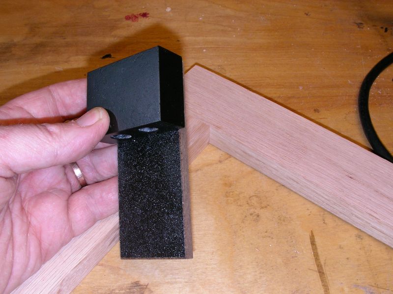

    After writing about my "sliding doweling jig" (based on a jig I saw in Fine Woodworking), I heard from a number of people that complained that: (1) They had difficulty drilling perfectly straight holes that are 1-1/2" deep and (2) They've had trouble locating the spacers I use as bushings.
    I've also thought long and hard about doweling jigs and how I could improve my design. To make it more universal, so that it could be used in table stretchers and face frames and cabinet carcases alike.
    While I was doing my thinking, I discovered that Rockler now sells an inexpensive doweling jig (only $9.99 as of this writing). Here, this one:
    http://www.rockler.com/product.cfm?p...er=dowel%20jig

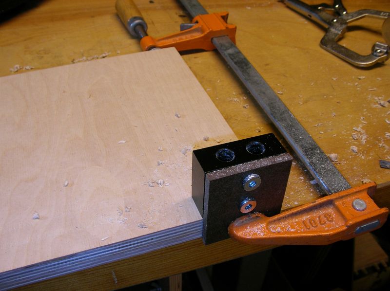

    It is simply a hardened drill bushing with two 3/8" holes, attached to a transparent guide featuring center lines. Rockler seems to really be pitching it for face frames.
    So I purchased a couple of them to experiment with, and I've come to the opinion that it actually ideally suited to all sorts of doweling tasks. With a little modification, that is.
    The clear plastic guide has got to go. First, it is too slippery and when clamped to the workpiece is inclined to allow movement while drilling. Second, I don't like referencing from the center of the holes of the guide. I prefer to reference from the edges of the steel bushing instead.

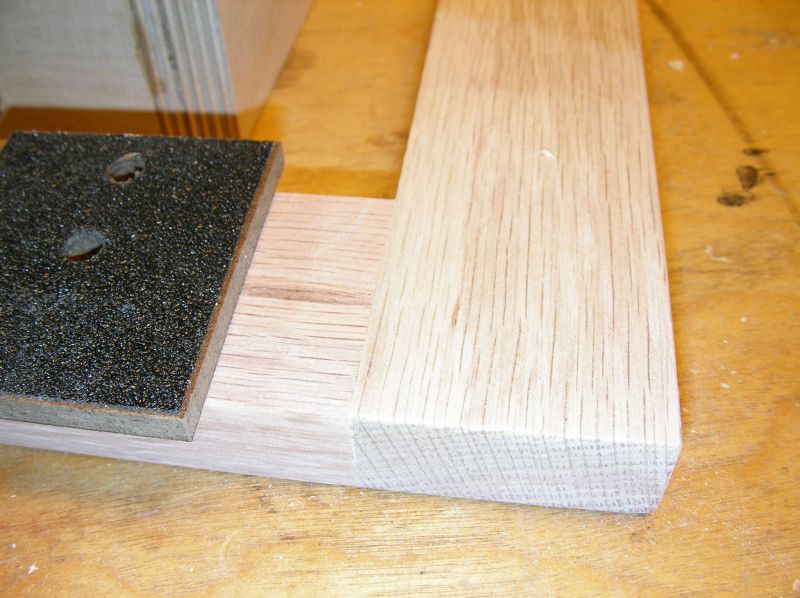

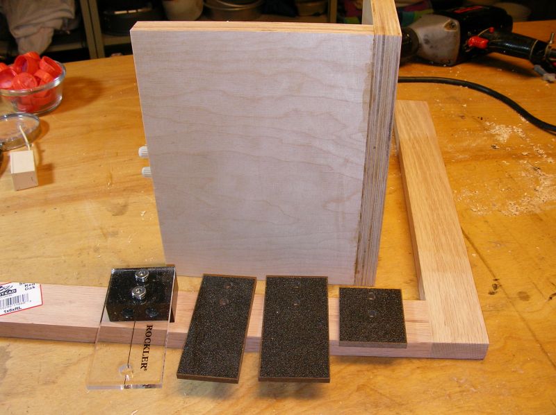

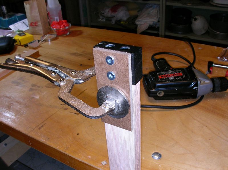

    So I made three new hardboard guides to replace the original transparent guide. Each board is sized according to its use: (1) This first guide is for face frames, and is 1-3/4" wide and 4" long. All my face frames are 1-3/4" wide, and the steel drill bushing is 2" wide. So using the edge of the steel drill bushing as a reference won't work. BUT, by attaching a 1-3/4" wide hardboard guide, I can now use the edge of my shop-made guide as a reference. I simply align the edges of the guide with the edges of my frame member, clamp, and drill my two holes. I don't think it could be any faster.

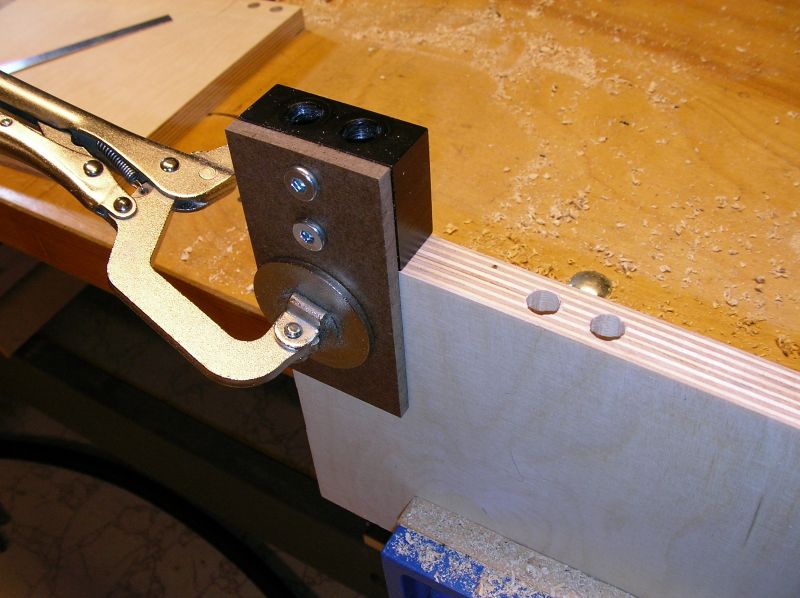

    (2) The second guide is for edge-drilling cabinet pieces, and is 2" wide and 4" long. It is a little redundant, as the 1-3/4" wide guide would have sufficed. At the time, I supposed the extra width would help in gripping the workpiece. But with the use of the non-slip stair tape (see below), that really isn't a concern.
    (3) The third and final (so far) guide is for face-drilling cabinet pieces, and is 2" wide but only 2-1/4" long (so it extends only 3/4" below the bottom of the steel drill bushing). This allows me to drill face holes in cabinet pieces.
    Each of my shop-made guides has non-slip stair tape covering it entire face. The non-slip tape extends all the way under the steel bushing. This tape provides a death grip that prevents the bushing from moving while drilling.

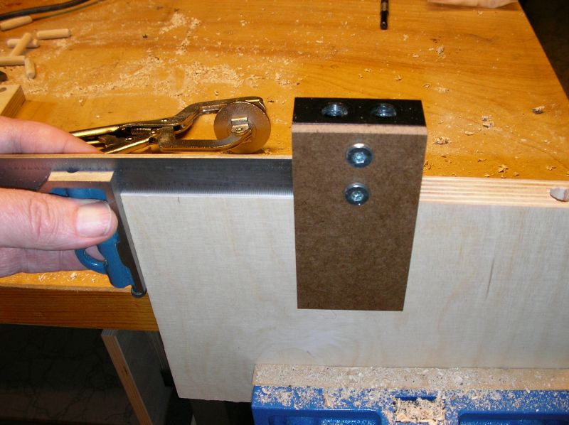

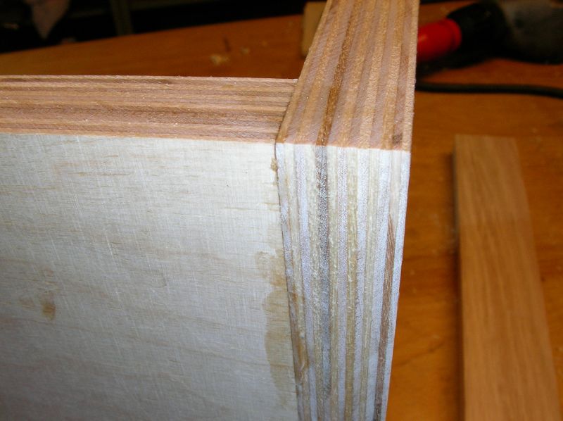

    While doing cabinets, the two pairs of outside holes (flush front and flush back) are easy, just align to the edge of the steel drill bushing, clamp, and drill. For holes in the center of the panel, simply use your combination square to locate the steel bushing. You can easily drill four sets of two holes with a single combination square setting (one referencing the front edge of the piece, one referencing the rear edge of the piece). If you need more, use two combination squares, or make a jig that references from previously drilled holes.
    I've included some pictures showing the unit in its various configurations (under use), and some of the results. I'm extremely happy with the outcome. Edges are perfectly aligned, and it requires minimal effort to achieve excellent results. Cost is nominal, and the design is flexible enough that I can easily add spacers for things like offset joints.
    I'm happy to have another alternative to joining wood that is strong, flexible, and very inexpensive.
    If there is any interest I have important information for others that might want to try duplicating this. But I don't want to get too technical in a first message.
    I have concluded that a drill bushing with two holes is actually ideal when it comes to flexibility. You'd think two holes is going to require excessive repositioning. That, four or five holes would be wiser. In reality, though, I don't often want to run a line of four or five holes in a row, you don't need that many closely spaces holes in a cabinet joint. And for something like an apron to leg joint, it is easy to get four holes with a single move of the jig, and the holes are arranged symmetrically in the joint. And for face frames (where two holes is obviously ideal) you don't struggle with a bulky jig that wants to fall off the frame member while you're trying to clamp it.

          Sorry for not responding earlier. There isn't that much more information, but I got tired of typing.
          First, for the narrow (1-3/4") face-frame guide, it is critical that that 1/4" holes are perfectly centered. This is because we're using the guide as our reference. A small (1/32", for example) variation in centering the holes will result in face frames where the end-grain of the stile isn't flush with the edge-grain of the rail by twice your error (1/16" in my example).
          This is how I find the center of the guide:
          I extend my combination square's blade to 7/8" from the head. I mark two center lines, one with the square's head referencing the left-hand side of the guide, the other with the head referencing the right-hand side of the guide.
          Due to the thickness of the pencil lead, or error in setting the square "just right" (or both), marking the center twice will result in two very closely spaced lines, or a single thicker line. True, dead center is the center point between the two individual lines or single thicker line. You eye will very easily be able to center the brad point of a 1/4" bit using this method. Just "split" the line(s).
          But there is one more point: When attaching the 1-3/4" wide face frame guide to the steel drill bushing, you need to square them to one another. Clamp a piece of wood with a square corner in your vise. Place the steel drill bushing on top and overlap the square edge by 1/8". Now adjust the guide so it is even with the edge of the board, and tighten the screws. Use your steel rule to confirm that the guide is centered on the steel drill bushing.
          You may want to make a practice joint or two to make certain you've got the fundamentals down. Don't hesitate to let me know if I need to clarify anything.
