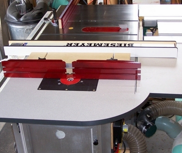

    Beismeier, excaliber, delta, and a few others make an overarm guard that work very well, but are not inexpensive.
    This one is shop made
    http://members.aol.com/Alamaral/Guard.html

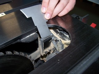

      I believe the splitter/guard are the same on your 22114 as they were for my former 22124. The stock guard was typically lame. My brother made a very effective pop-in splitter from stainless that I liked alot. I never did get around to working out a guard solution.
