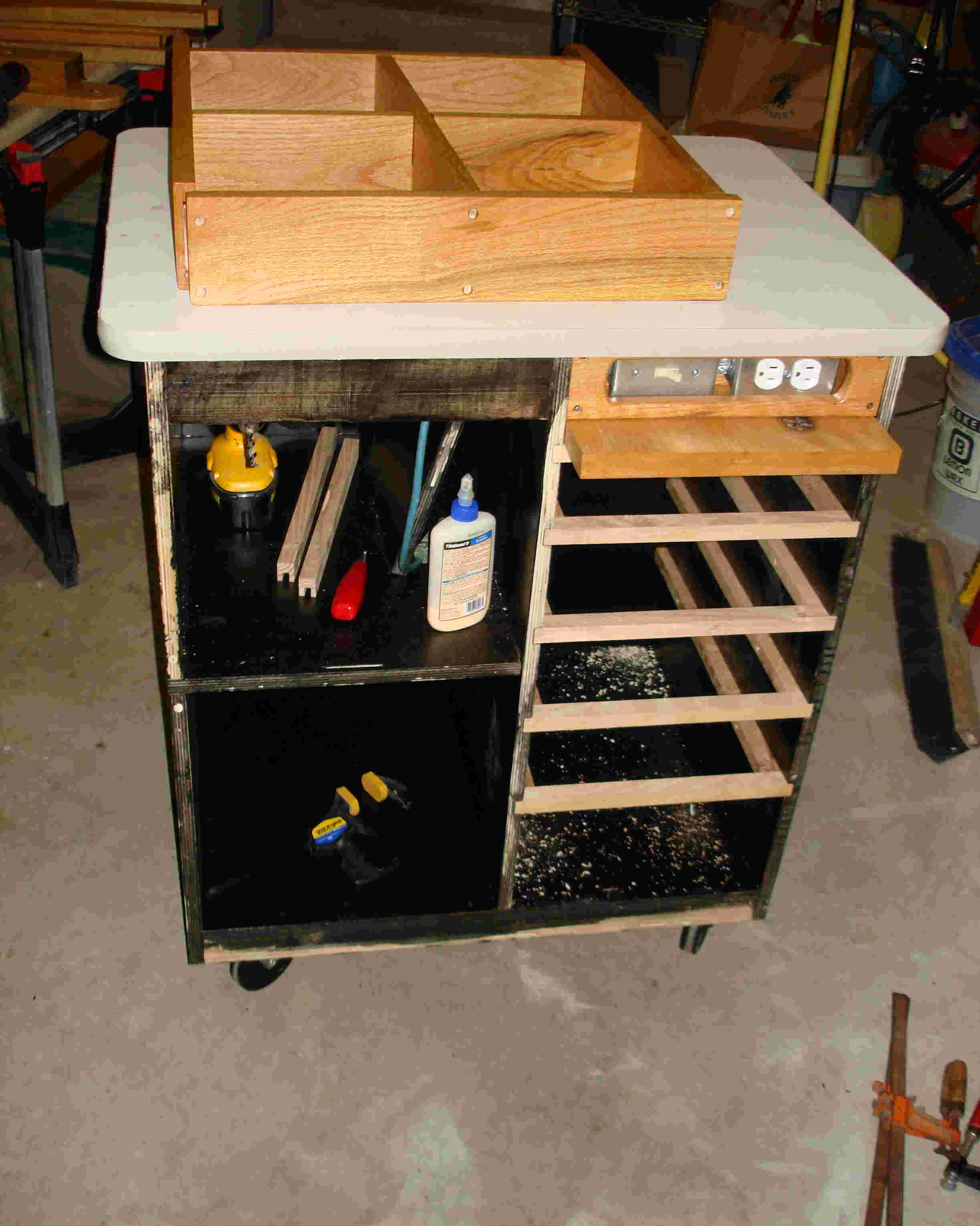

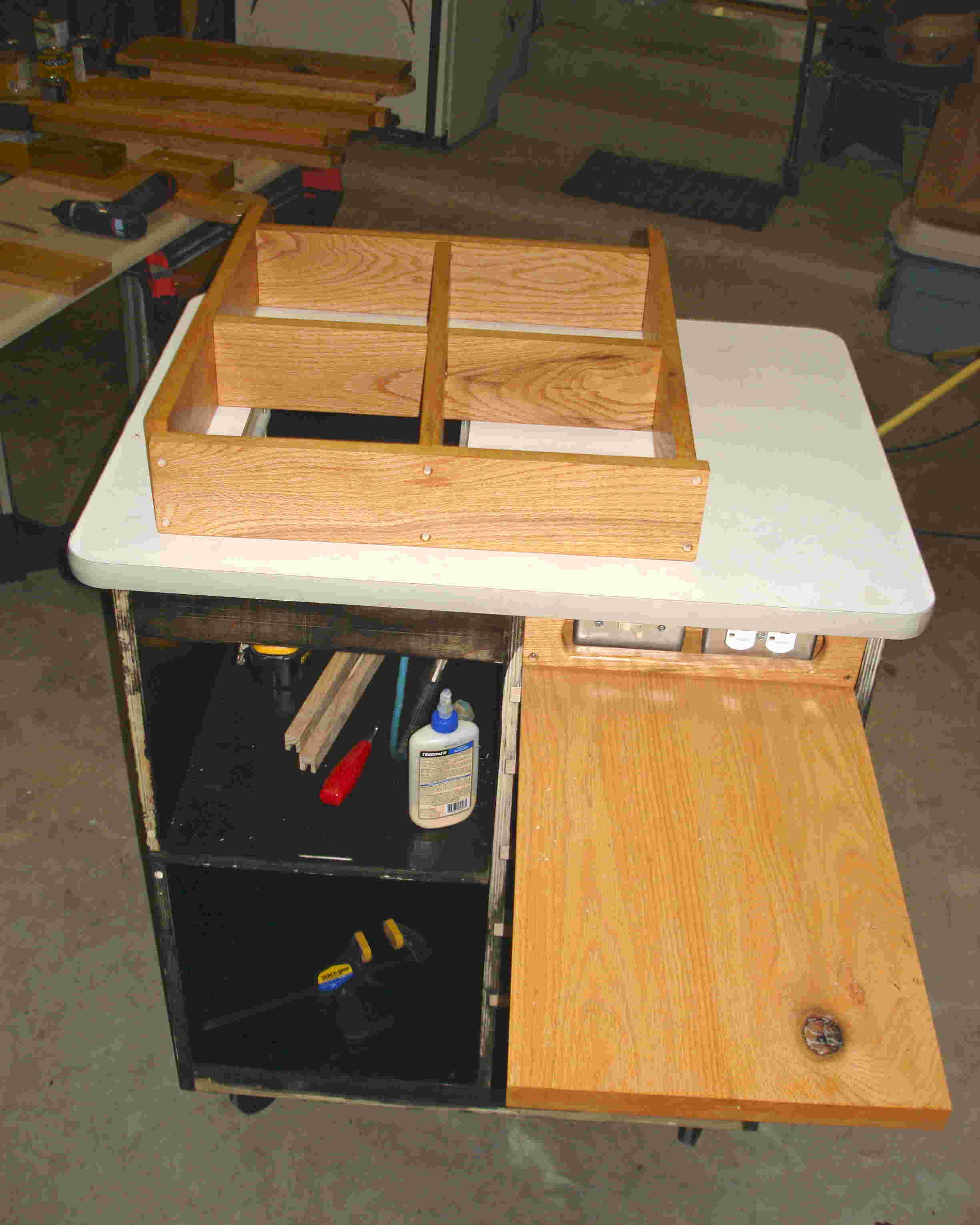

        One thing I am adding to my router table (currently under construction) is a pull out work surface. You might consider this as you are setting up the table.
