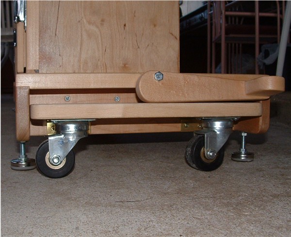

                I have a shop built base under my G0555 from Wood magazine plans but I couldn't find a picture of it. Several members have made them and someone should have a picture of their's that will be posted.
                The lifts at the ends of the lathe cabinet are based on the same plans.
Name:	Caster lift and feet.jpg

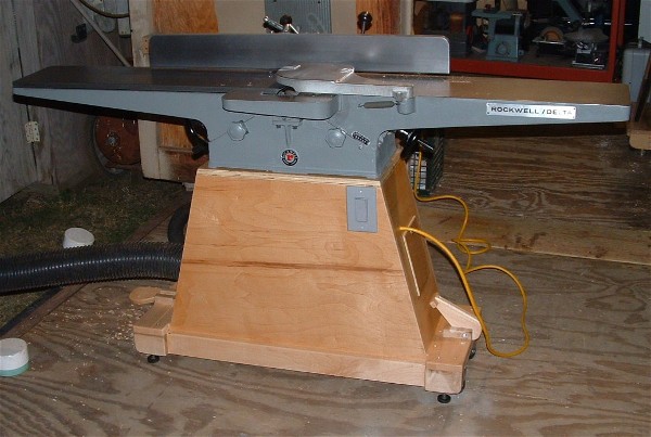

                I redesigned the lift mechanism for the base on my jointer and the lifts for my BT3.
Name:	Up and Running.jpg

                  Sorry about resurrecting an older thread but I am in the process of finally designing a mobile base cabinet for my BT Frankensaw. I have been researching all the available caster/locking feet options and I was wondering how your redesigned lifting mechanism worked out. Do you have any details on the construction of the top horizontal piece of ply that the lever mounts to? Is it notched to allow the lever through? What is the outline of the lever itself?
                  Sorry for all the questions but I currently have a homemade mobile base under the saws based on the same Wood magazine design but the saws were too heavy for the casters I originally used and the cam lever never really worked adequately. Thanks for any advice!
