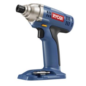

    Impact vs hammer drill
    Looking at Ryobis' cordless impact 18V drill and 18V hammer drill. Is there any difference?
    No good deed goes unpunished
  • MilDoc
    Impact drills basically "hammer" the driver in a circular motion, helping to drive screws, etc. Using one I was able to drive 1/2" bolts into studs easily.
    Hammer drill's impact is vertical, along the line of the bit. Great for concrete and other stuff.
    Hope that makes sense, but I'm sure someone can explain it better.
    • Tom Slick
      • 2913
      • Paso Robles, Calif, USA.
      • sears BT3 clone
      are you sure it was an impact drill? An impact driver is basically a heavy duty screwdriver but it does not have a chuck and does not make a very good drill.
      A hammer drill, as MilDoc eluded to, is a drill that vibrates to drill though concrete and brick. It does not make a very good screwdriver.
      • Hoover
        • 1273
        • USA.
        I looked online, and you are correct, one is an impact driver, the larger pic, the smaller pic is the hammer drill. When I was at Home Depot, I thought that they both had chucks. My error.
        Since my eyes need new glasses, is there any reason to buy a hammer drill for woodworking?

          If you already have a drill, then no. The hammer function is only for concrete and such. It hammers the bit forward to help fracture the concrete and keep pressure on the bit easier. Hammer drills go through concrete a LOT faster than normal drills.

              Most hammer drills can be switched from hammer mode to standard drilling, making them good for any project where hand drilling is required. When you need to drill even one hole in concrete they justify their purchase.
