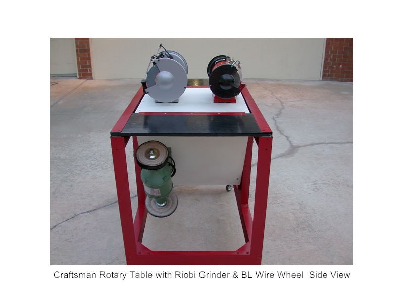

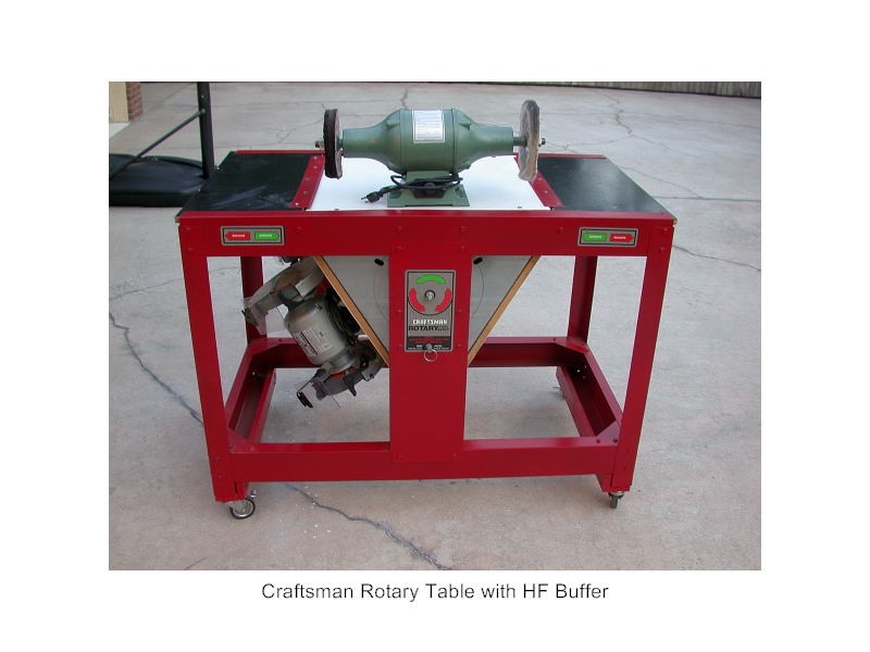

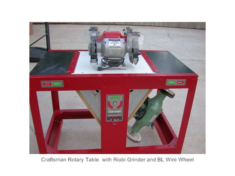

                        Workbench with tool rotator example
                        Hi,
                        I have had one for about 10 years and I like it but I do plan on building the tower system too. This started to rust so I painted it to go with my color scheme of Red, Black, & White. I left one side open so I could use it as a table top and pile stuff on top when I was not using it.
                        Here are some pictures:
                        Bob Pepple
