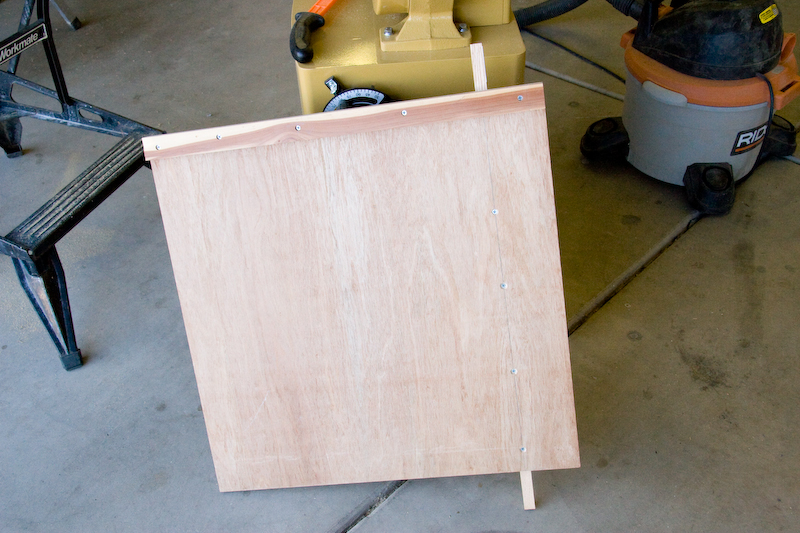

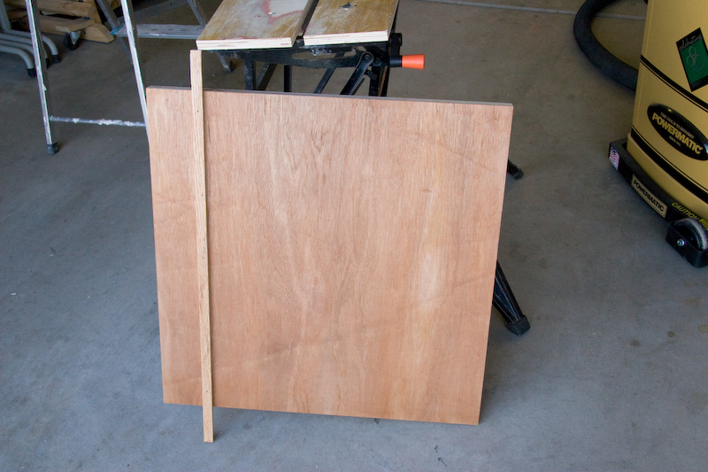

      Construction is really simple.
      1 piece of good ply, I used some 7/16" I had lying around.
      1 HW, I used some oak, (or metal) runner planed for a snug fit in the miter slot. The thickness should leave some clearance at the bottom of the slot.
      1 fence/stop with a sq face.
      The key is to make sure the fence is exactly 90degrees to the base.
      Joint and size the runner. Cut the base to the length (depth) you want. Cut the width to rough size (approx 1 inch over). Measure from the blade to the center of the miter slot. mark a line on the base this measurement + 1inch from the cutting edge. Fix the runner to the base, counter sinking the screws. Place the runner in the miter slot and run it through the saw to trim the excess. The base is now cut to size. Take your fence and using a good framing square attach it to the head of the base again leaving a little extra over the cut line. trim the fence as before and thats it.
      I will have some pics later.

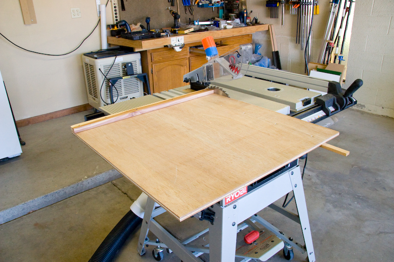

        As promised here are some photos.
        I built the sled to sq up the base for the DP to sit on. More on that in this thread.
        http://www.bt3central.com/showthread...077#post349077
        As you can see the sled is very simple. I have just given the underside a few coats of wipe on poly and I will wax it when its dry.
        Having done this I guess I should build the crosscut and miter sleds also
          Jon,
          I like that design, allows the blade guard to be left in place. Do you secure the panels to the sled, with clamps for instance, or is manual pressure enough to keep them stable? Also - the surface under the sled in the photos - is that the SMT locked in place, or a second accessory table?

              Originally posted by b0330923
              Jon,
              I have only cut a few things with it and manual pressure has been fine and yes that is the SMT table. Yet another job is to make up some shop made accessory tables - one day :-)
