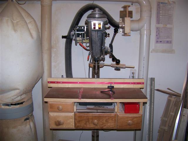

                        I roughly followed the plan of a similar table in Wood magazine. It has a t-track in the fence for stops and part of the fence slides out to give more support and range. I almost never use this feature, however. One nice feature is to make the top surface 1/4 tempered hardboard and make the center part where you drill replaceable. My top surface is two layers of 1/2 BB plywood plus the 1/4 hardboard. I put several drawers under the top for bits (my drill press is a floor standing model). I screwed it to the steel drill press table from below and shimmed it with old business cards to get the top square to a piece of steel rod in the chuck.
