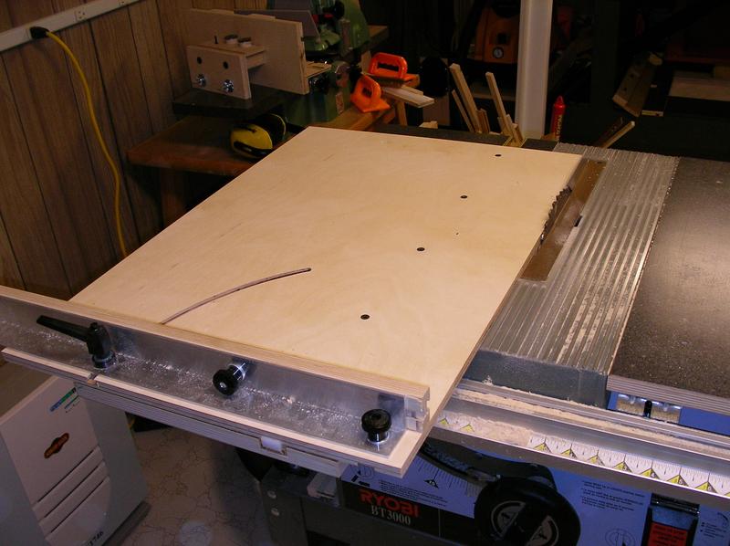

    I will be building a larger cabinet and needed a sled that could cross-cut 24" panels. I wanted a single-runner sled (cause my table saw only as one miter slot).

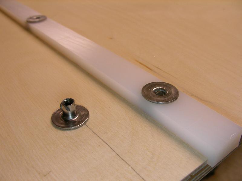

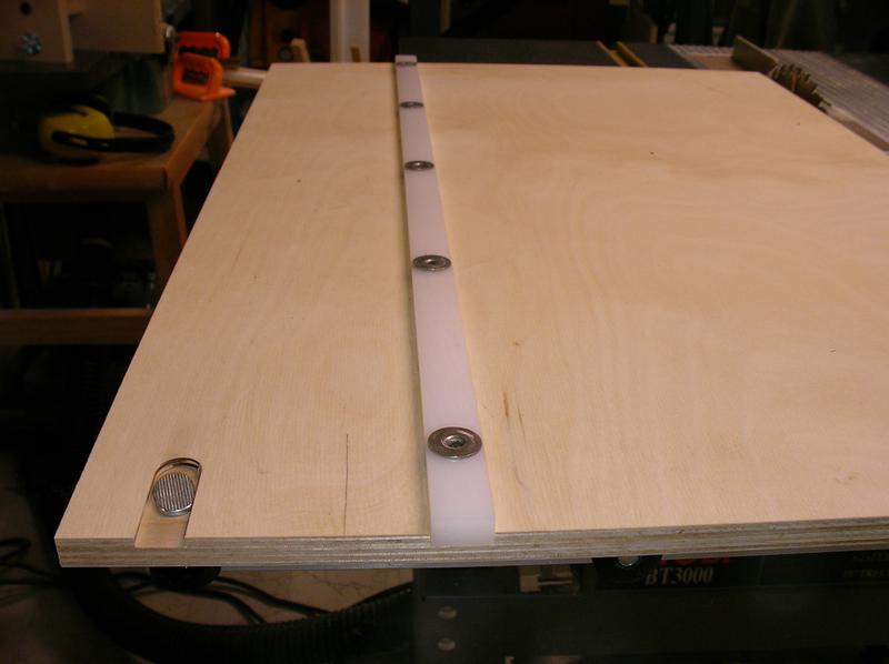

    This is what I did: I routed a .75" groove in the bottom of my new sled (1/8" deep). I centered six 3/16" holes along this groove (at 6" intervals), and drilled some matching (but slightly larger at 1/4") holes in my UHMW runner.
    I inserted special prongless t-nuts into the UHMW plastic (I used my woodworking vise to just squeeze them in). These nuts, BTW, are sometimes referred to as Propell nuts, sometimes as Hurricane nuts, McMaster just sells them as t-nuts. I used the #10-24 size (they have a base that is 45/65" in diameter).
    Inserting the t-nuts into the runner made it "bulge" up to .752" around each nut.
    I screwed through the top of the sled, through the runner, and into the t-nut. Trying the sled in my miter slot it was a little tight. A couple licks with a cabinet scraper at the "bulges" and it slid perfectly, no play and slides like butter.
    The best thing is, I can actually tighten the screws from the top and the plastic bulges a little more (and the runner tightens in the slot). Loosen the screws and it slides like butter again. So it is slightly adjustable.

    You may wonder how to achieve this with a dual-runner sled (if you're one of the lucky ones with two miter slots). My suggestion is to make two single-runner sleds (one for left of blade, one for right). Then, with the sleds in their respective slots, attach the front and rear fences to join them together into a single unit.
