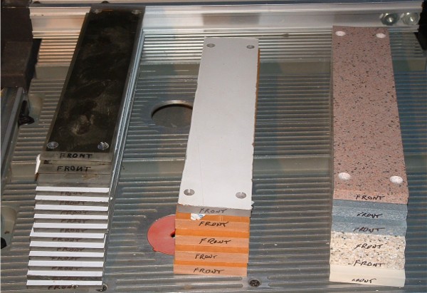

    I cut a variety of blanks a while back and have been moving them around to keep them out of my way. Finally decided they needed to be machined. I got them all drilled and countersunk tonight and hope to route the edges tomorrow.
Name:	ZCTP in progress.jpg
    2 - 7/32" Lexan
    12 - 1/4" Lexan
    1 - 3/8" Lexan
    4 - 1/2" phenolic
    6 - 1/2" Corian
    The 1/2" will be used for dados, the rest will be cut for different blades/bevels.

          Pappy,
          Using Corian as a plate had never occured to me, up til now I have mainly made them laminate flooring or Oak moldings (these work well), being wood they do get dinged a bit.
          How does the corian work, can you cut with regular blade? Did you just pick up some scraps somewhere or buy a big piece?
            Jon, the Corian works great for dado plates where the riving knife/splitter isnt used. It is on the brittle side and with the slot for the riving knife cut so close the the rear part of the 'meat', one drop and the throat plate is history. I have one set up for a full dado that has been in service for a couple of years.
            I have a counter top company at the end of the street. I get drops about 2' x 3' from the dumpster.

              There is another counter top product that is very much like Corian, but not as brittle. I had a Corian plate and it broke near one of the outside screw holes. Whatever this other stuff is has held up for over 4 years in my saw.
              Checking with a counter top company may yeild some answers.
                Lee - I'll pass on that idea.
                Hmm, have to go and search out a counter top place and rummage through their trash
                how tough is it to raise the blade through it? Is it likely to dull the blade much?
                  Easy to cut through and no harm to the blade that I can tell.

                      My ZCTP material of choice is white plastic cutting boards. They are about 3/8" thick, durable, reasonably slick, and CHEAP!

                          No fancy materials here -- I make them out of 1/2" BB, and after a few coats of poly and some wax, they're nice and slick.
                          I prefer using the four holes so I can flip the dado ZCTPs 180* and get two-for-one.
                          With 3 ZCTPs, I can cover all six combinations of chippers.

                            Nice run there Pappy. I usually make 6 at a time from BB ply as I tend to chew one up about every 1 1/2 to 2 weeks. I may try that corian as phenolic is kind of high. Lee that owns the Woodcraft brand phonelic seen in WW stores is about 20 miles up the road from me in Gainesville, GA. I may ask him where he gets his phenolic but in the quatities I could afford, proabably still too high for me to afford.
                            Yep.. the corian sounds good and the dumpsters at cabinet shops may be a good place to shop for a real bargain.
                            Regards...
                              The only thing I use the corian for is dado plates. If you use it for a single blade and cut the slot for a riving knife they have a tendency to break at the fear.
