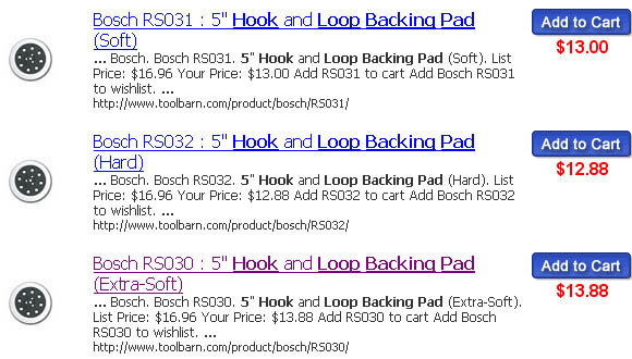

        There seems to be a hard, soft, and very soft models. What are the advantages of the different types?
        http://www.toolbarn.com/cgi-bin/sear...+&dom=toolbarn

          hard is for sanding surfaces that you want to keep flat and sharp and rapid material removal. soft is for countours and isn't as aggressive.
