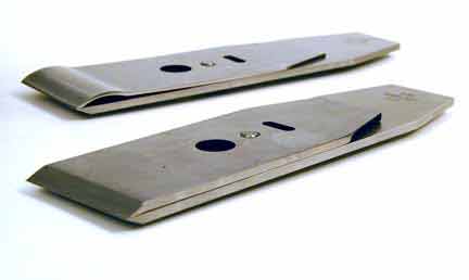

                Don't rule out buying an improved chip breaker, which helps cut down on vibration and chatter. Lie Nielsen sells them for approx. $20.00. The Lie Nielsen is in front.
