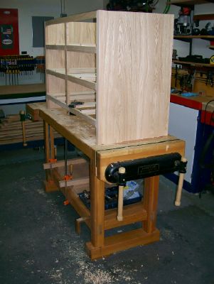

    I've been checking into the various options for flattening wide panels, which for me is anything over ~13". I'd like to see what you guys are doing and why. The obvious methods seem to be: have a shop do it for you (hate this idea, I could just have a shop build stuff for me too), handheld belt sander, handheld power planer, and hand planes (e.g., a jointer plane, like a #7).
    The only one of these I can try without buying something is the handheld belt sander option but that has limited appeal (basically, just that I don't have to buy something).
    I have a 20" planer.. therefore my limitations go to 19 1/2" on one pass. But still the same scenario as I just did two side panels with a top to come that runs over that. I glue up not to exceed my planer width. Then I run the glued panels through and glue the 2 (possibly 3) sections together. That way I have less work with a #7 hand-plane.
    I am not a fan of belt sanders other than exterior home work, but that is an option that could be used. You could pay a shop just to flatten a panel with their drum sander if you are not an every dayer and can't see the justification in an investment up-grade.
    But.. if you intend to do this for a long time and are going to do lots of large carcasses as I do.. I highly suggest that you get a jointer hand plane and a smoother and learn to use it. That's how I started 36 years ago and if the power goes out today.. it worked well for 5000 years and it will work this again this morning.
    Even with large equipment as I am fortunate to have.. there are cases where you still have your hands tied behind your back by not having even larger capibility. Learning to use a hand plane was once a basic.. and it still is even though few recognize that. It delivers enormous ability to go where your power equipment can't go and you are not limited to size.

                              Eddy, you've actually hinted at one of the things that kind of scares me about hand planes, always wanting another one... I'll go ahead and get a jointer plane for now and do some learning (sounds like there's a lot of learning curves with tuning, sharpening, using). I like the idea that using planes is even more of a hands on process than power tools...
                              I made a router sled last night out of an old plywood headboard. I tried it out with my nicest bit, a 1/2" CMT, on a 20" wide piece of glued up red oak which I've been experimenting on. I was surprised at how nice the surface turned out (obviously needing clean up but not bad). I'm definitely gonna need a bigger bit though.
