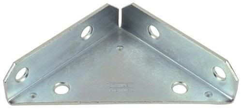

    About a week ago, I happened to be in a local liquidator's store that is sort of like a cross between Big Lots and Harbor Freight. Browsing the tool department, my eyes landed on some heavy-duty 4" galvanized steel corner braces from Stanley:
    Price: $2.75 per pair. I was idly musing that that might not be too bad a price to pay for some strong brackets to build some new wall-mounted clamp racks ... when suddenly, the light went on.
    At home, in the shop, I tore open the blister pack, positioned the corner braces at the edges of two scraps of plywood each about 12" long, clamped everything together, and checked the result with my 12" Starrett combination square.
    The verdict? Absolutely dead solid perfect. I couldn't see even a glimmer of daylight beneath either leg of the square.
    These braces are 4" long versus 6" for the nice alumimum jobs from LV, but hey ... at less than one-tenth the price, I can live with that. The Stanley part number is 755565. They're probably available at the big box stores, although I'd expect the price to be somewhat higher than the $2.75 I paid. Still should be a ton cheaper than thirty-odd bucks, though.

        Nice catch Larry. I use these to reinforce library chairs that I have been rebuilding over the last year and the thought never occurred to me. I think I pay about $4.50 for a pair of 3" ones at HD. I checked the ones I have and they're not perfect but they could be brought to square with a few hammer taps. Thanks for the tip.

                        Well, it turns out there's some luck-of-the-draw involved. Yesterday I went back and bought three more sets of the Stanley brackets; I wanted another pair for assembly purposes, and the remainder just to put in inventory.
                        Two pair were fine; but in the third, one bracket was bent to form about a 95deg angle! This probably would've been apparent even in the blister pack, if I'd looked closely. So, check carefully any pair that you may buy. These are a good deal if they're actually square (and, again, three out of the four sets I bought are) but useless if they're not.

                            I bought a pack yesterday while at Lowe's. If my drafting square is right, both appear to be dead on 90. I took a Sharpie and marked them so I would remember what they are for.
