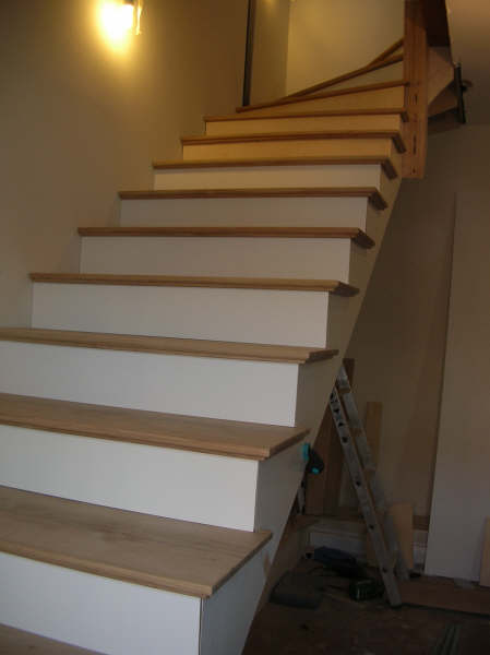

    My brother got one recently, and managed to build this with it.

        The photos above are of the CMS and this is not available to the US market. The MFT is available in 2 sizes. While you will need a Festool circular saw to make use of the rail on the MFT you can use other tools and jigs for holding while sanding, etc. I would not buy it if you do not plan to purchase their saw (or Makita's knockoff).
