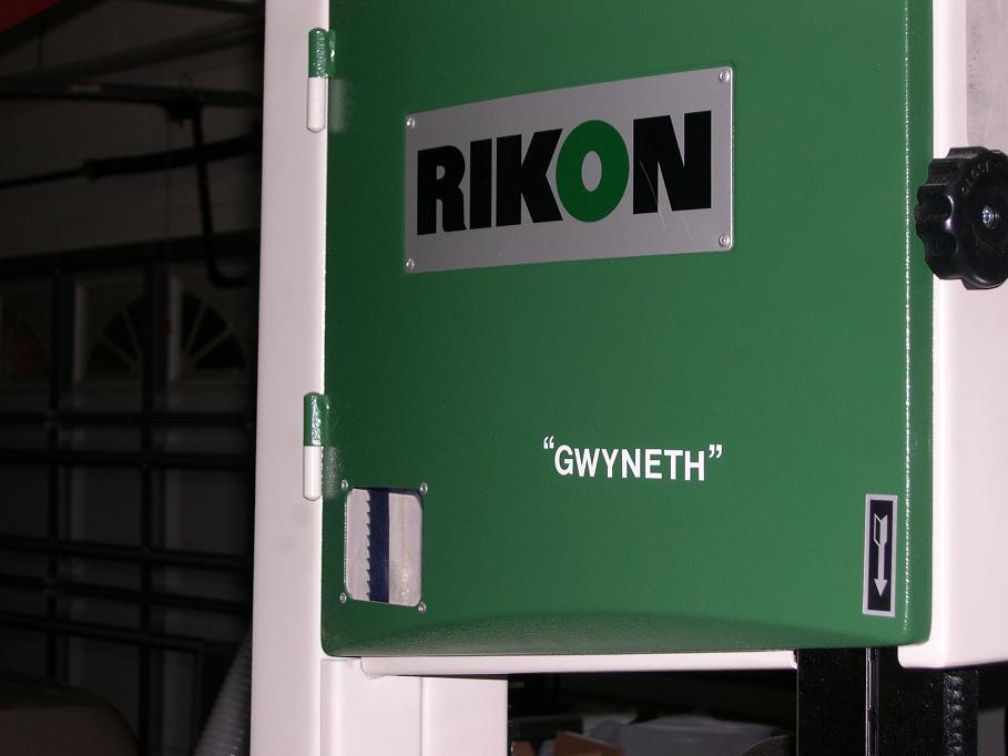

    Considered it recently when upgrading my BS. Went instead with the Rikon deluxe 14". Has same size motor as most 16", and even bigger re-saw capacity. Top rated saw in most tests, and $200 cheaper than the Jet 16". But the Jet is a good saw nonetheless.
      As Uncle Cracker's bandsaw's godmother, of course I can't resist the chance to chime in (and send it an e-chuck under its chin).
      The $200 can buy some really nice blades and accessories...
        She's not just kiddin', either...
