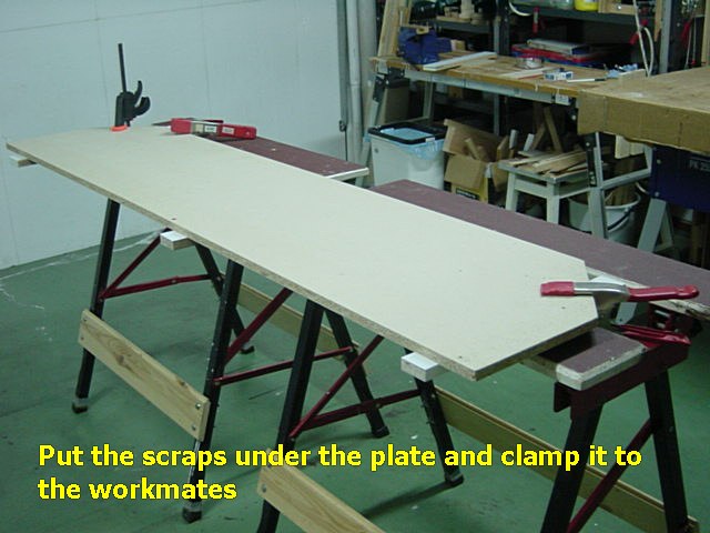

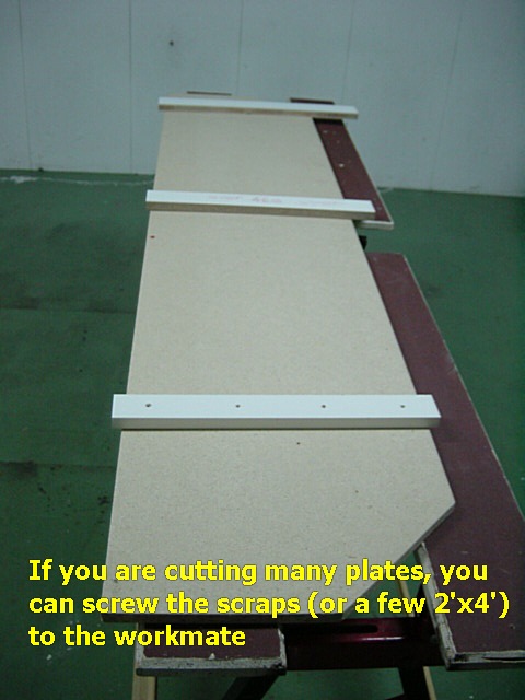

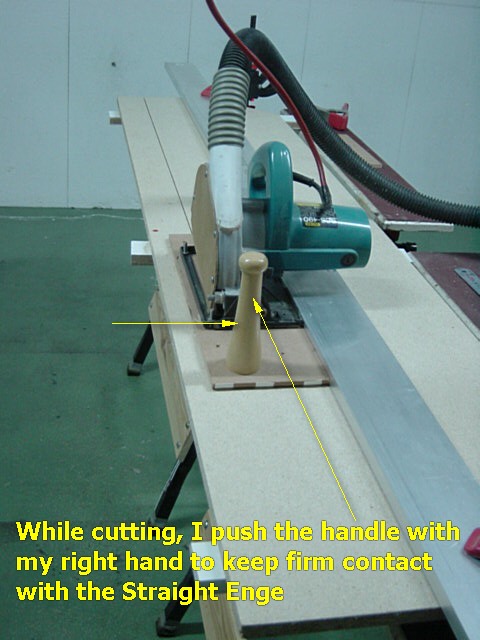

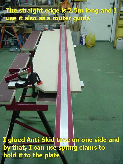

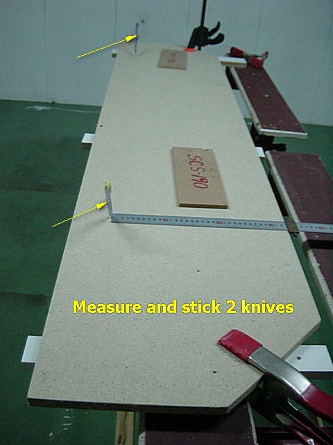

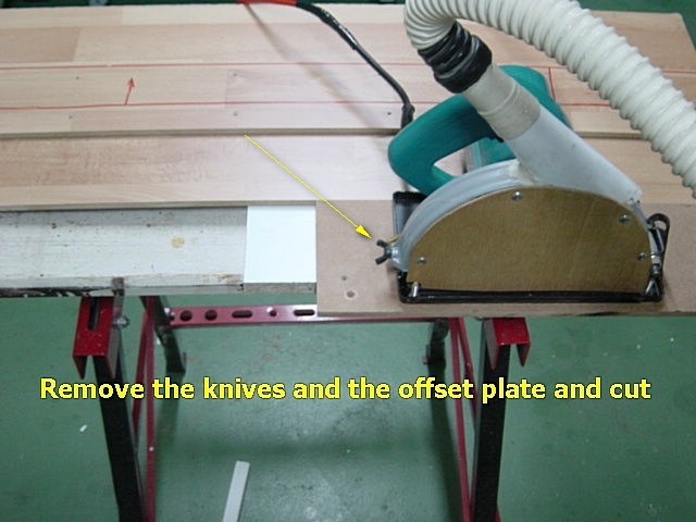

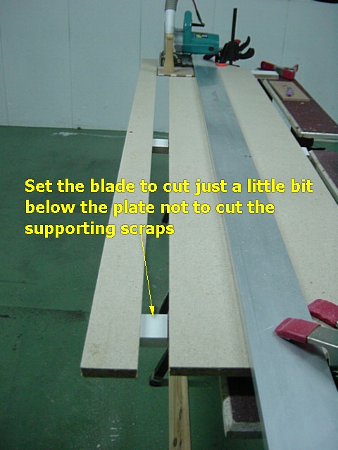

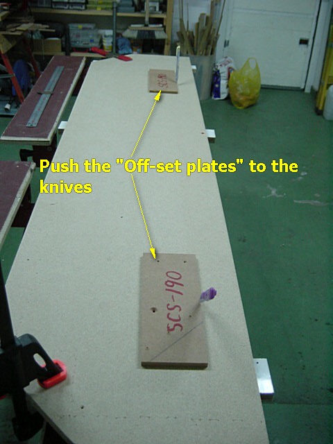

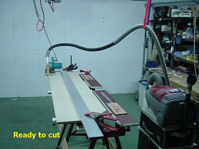

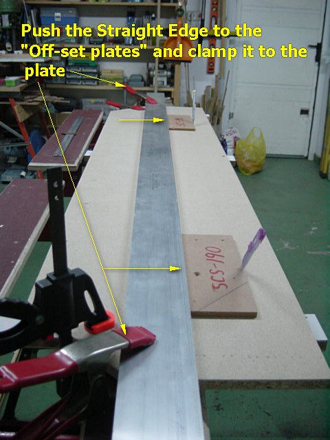

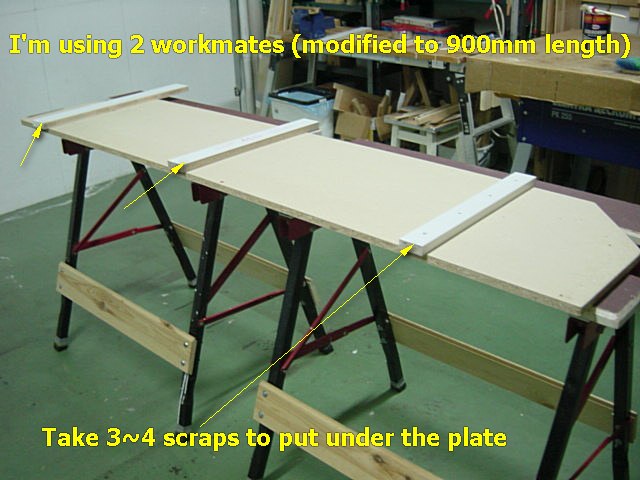

          Hi David
          I did not explain myself good.
          To lift the saw up, I have to release the wing nut at the back of the saw as you can see on the first picture.
          After I lift it and lock the wing nut, the back side of the saw is supported on a thin slotted strip and that strip allows the back side to move left/right if I apply left/right pressure on the handle.
          On the other pictures, you can see how I do it with "support strips" under the plate
          Regards
          niki
