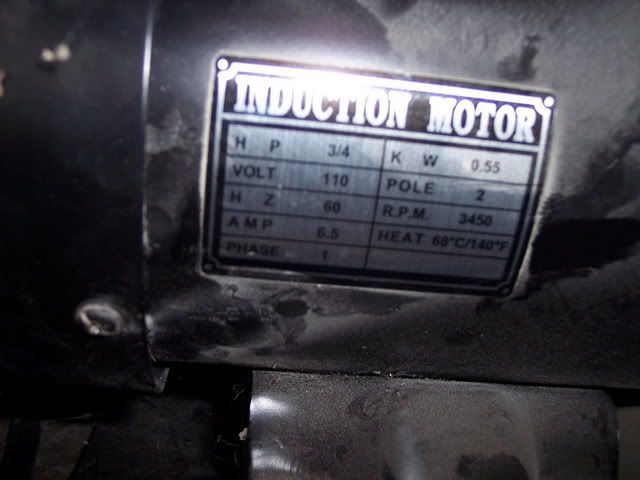

    If anyone has a Protech portable dust collector, can you tell me what amps it is? Mine is stamped with a number that is so light, I can't make it out. I am laying out my shop and need to know the amps to not overload the circuit. Also, what is your experience with this unit. Seems pretty weak, but need to live with it for awhile. It looks exactly like the portable unit sold by Woodcraft but the Woodcraft might have a more powerful motor. Thanks.

    Is there a horsepower rating on the motor? If so we can compute the amperage.

      6.5 if mine is the same as yours,
      this is a little thing on wheels with a single bag out the side dust collector,right?
      edit> I just checked out the Woodcraft one-it looks the same except the housing on my Pro-tech is a tan color.

        thanks for the info
        I appreciate you taking the time to send the pic. Are you using this and what has been the performance? I bought mine on a close out and needed one and not too much cash since I am starting a shop and buying everything new. Thanks, Jake

          thanks for the info
