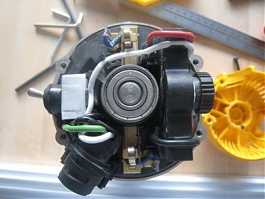

          ken, thanks for the instructions. I couldn't locate the brushes. I might be looking at the wrong location.
          I removed the screws at the bottom and at the top. Used compressed air to blow out the dust. Plugged back in and the motor started and ran for several seconds. after few seconds couple of times the motor sounded like it is slowing down. then it died.
          Here is the pic of the top cap removed. where is the brush?

            I think the brushes are at 12 and 6 o'clock in the picture inside those rectangular gold colored holders. Here is a link to a parts breakdown of the router. The brushes are item #20, although not shown in the diagram there are usually two.

              Thanks!. It looks like it is easy to change. Two clips are holding them inside the holders. Instead of ordering the part from online, I'm going to take it to local Dewalt service center tomorrow and find out how much it will cost me. I might be able to buy the part there.
