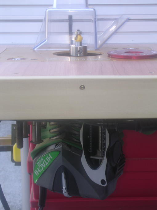

      I have one on my M12V mounted in a table and have no complaints. There are more expensive and more accurate ones, but for the price mine is ok. Takes a little drilling to mount it but they provide a template depending on your router. I took the springs out of the M12V and have had in in my table (Rockler table top and plate) for 3 years with no problem. I have PC693 with a fixed and plunge base for hand work. That M12V would be a handful for me to be hand held. You have to lower the M12V with the Router Raiser to change bits, so I have to pop the plate/insert out to change the bit, but thats not a big problem. There is a collett/shaft lock I have to press before losening the collett with a wrench so above table bit changes would be problem with the Router Raiser and the M12V, don't know about the M12V2.

          I have the router raizer and installed it on the M12V. It works great and you get great tech support. I would suggest that you call Router Raizer before you start the installation and you will be able to get good tips to make the process go better and faster.

            Seems like a popular combo, Router Raizer & M12V. I have the same.
            Installation was straightforward. They include parts for almost every router - when I saw the miriad of parts in the box I thought it's gonna hard, but I only needed used a few of them. Took about an hour to set up.
            I'm very happy with the performance too, and although I might one day upgrade to a better lift, that day is pretty far off.
