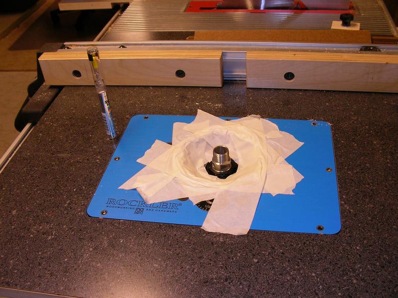

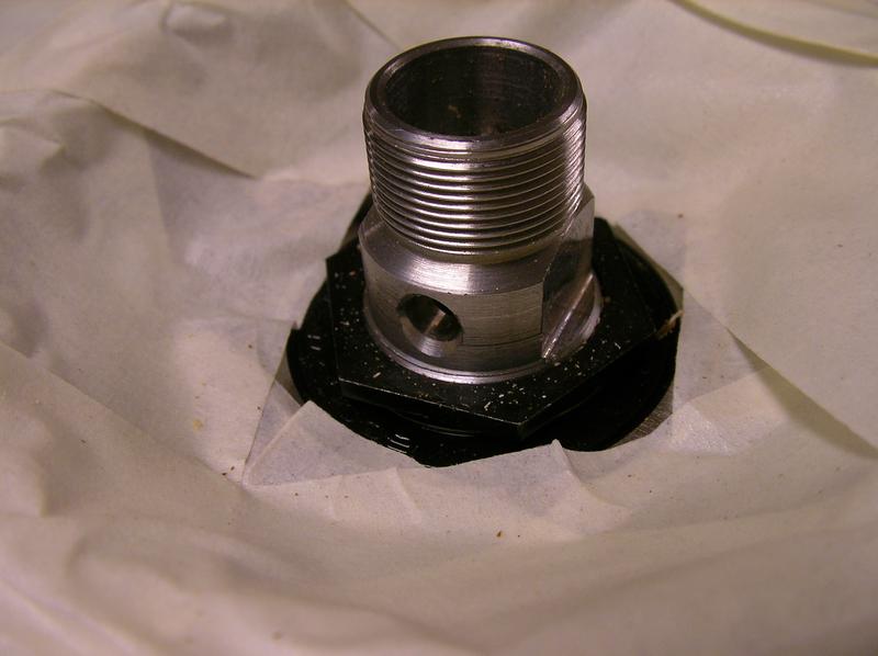

    I started using a little oil on the bearing and spinning the shaft by hand. At the time I had the router out of the table. I could tell it was working its way in. Slow, but sure.

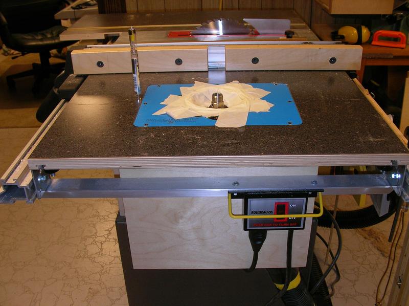

    But then I thought, I could put the router back into the down-draft box and use the vacuum to suck the oil into the bearing. I just sealed everything off w/ tape, so the only way in for air was through the bearing.
    It works pretty good. I put some oil on the bearing joint, turn on the vac for about five seconds (while spinning the shaft by hand). After turning off the vac I continue to spin the shaft for about another sixty seconds. It doesn't suck in huge amounts of oil, but it sure goes in faster than with gravity alone.
    I repeated this a couple of times and it spins pretty much like new. Noise on spin-down is gone.
    I guess only time will tell how long the repair will last.
