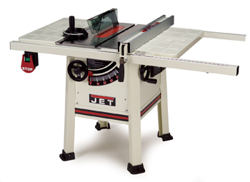

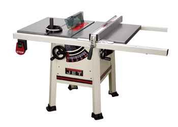

                          I just finished all of my TS research. I shopped the Ridgid, Delta and Grizzley. I ended up with the JET ProSHOP. It's amazing so far (three days) and is a hybrid as well. Beautiful dust collection. Perfect cuts. Solid and strong fence.
                          Here's a pic. It retails for near $899 or $999 (sometimes more) but at my local WoodCraft, they just ran a sale on it and offered me an additional 10% off. Pricing dropped down, after everything, to $540 (steel wings) or $630 (cast iron). I opted for the latter.
                          I'm sure your local WoodCraft owner will strike a deal to move one of these new model offered by JET. The build is very nice. I really love the STOP button.
                          Check it...
