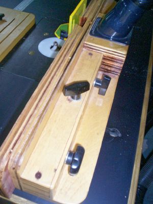

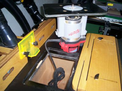

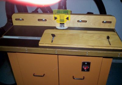

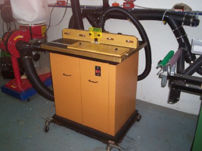

                      I think that is a good price for that router table top. I made my own also and have a very similar layout but I do have full supports under the T tract sections. I will say that my top is about 1 1/2 thick too.
