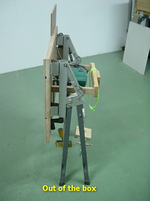

    It was running in my head for long time and now that I made the new router table, I made it.
    I did not make any project yet just a test that you can see on the last 2 pics but it's working nice.
    The setting might look very long (on the pics) but actually it's very short. The "Fence stops" are set only one time and the "Roller unit stops", two times (one for left and one for right) but it takes seconds.
    On the test, I cranked the router up in increments of 3~4 mm but I felt that I could lift more for each pass.
    Regards
    niki

        And to me, the amazing thing, this is all built on what appears to be a Harbor Freight cheap-and-flimsy folding workmate table.
        "Router lift would be nice" - why? You've got an AWSOME home-built one going there. Just impressive as ****.

            You are correct, I made the spacer blocks some 5 years ago and they are very useful to set stops on the fence and for doweling on the router table.
            Sometimes, I'm using a few of them to create bigger that 8 cm (3¼") spacer.
            Final t
            It's not so cheap workmate, I bought it in Japan and it cost around $50 but, I can lift (fold) the top without any effect on the legs (the pic below is my old router table).
            Gwyneth
            No books as long as I can walk to the garage without walking stick ...much more interesting...
            Thanks again
