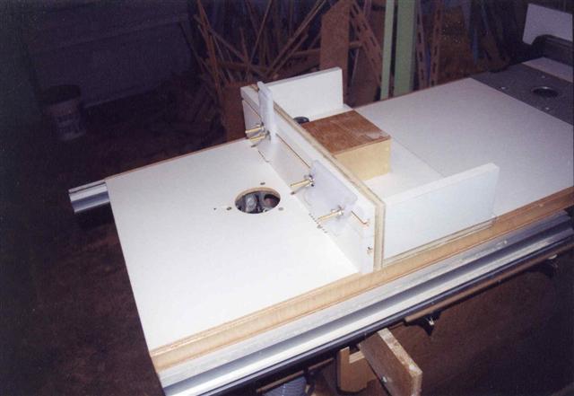

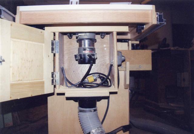

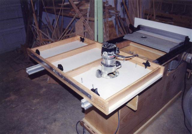

                    I have a router table setup in the extension table of my BT3100 (which has extension rails). The extension table is melamine particle board with ribs underneith and plywood glued to the edge for mounting to the rails. I reduced the thickness to 3/8 in an area the size and shape of my PC690 router. I built a separate fence so I do have to use the BT3100 fence.
                    These pictures should give you some ideas. I have an enclosure which bolts to the underside of the extension table with hanger bolts that gives me pretty good dust collection.
                    I have a separate router table that doubles as my infeed table for the BT3100. It has a homemade router lift which is the only big advantage over the 3100 setup - which still gets used occasionally.

                        No slam taken! You raise a good point and I have thought, from time to time, that I might like access from the end.
                        However, the current set-up is such that I can control the router with the main switch on the BT3100. When I use the router I remove the saw fence and guard and lower the blade below the surface.
                        The router fence is attached to t-tracks and can be easily removed for free-hand routing or when using the saw (as it is most of the time). The lift is a JessEm lift so the bit / collet can be lowered out of the way when not in use. It does require plugging and unplugging as I change from the saw to the router. So far I haven't had serious inconveniences with this set-up and it has worked for me.
                        Regards, Steve

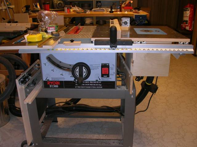

                              I did it three times!
                              BT3XXX (a little hard to see - acc. table w/ router on far right):
                              Craftsman 22124:
                              Unisaw:
                              Making my BT mobile with a built-in router was the best thing I did for my woodworking hobby. My garage is my shop and the tools need to be put away after use. Before being mobile many times I would decide not to make something just because of the pain of taking out the tools and putting them back. An added benefit you can see from many of the replies is the storage capabilities of a mobile base saw cabinet. My latest Uni set-up (hopefully my last) really works out great.
