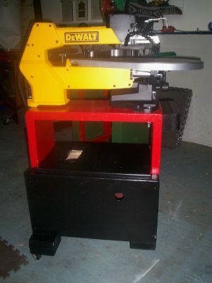

    Having just purchased a DW 788 SS re-conditioned, I had read much in advance about vibration from most scroll-saws. The DW was as quiet as any of them with it's parallel link arms as on the Excalibur when mounted to the DW tri-pod stand according to the guru's.
    The tri-pod cannot rock as a regular 4 legged table or bench on and un-even concrete floor and I think we are all familar with those. The tri-pod design of that base is very clever indeed and like a 3 legged stool. But does it have to be sacrificed if one wants to "go mobile" with his scroll saw?

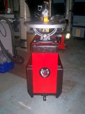

    A week of tinkering and "trial and error" concluded with a rock solid.. absolutely no vibration even at the highest speed.. and mobile all under the same roof. And by Monday an on-board "geinie" vacuum will ride in the "belly" in the forward position. No thoughts of motorizing for the street... yet!

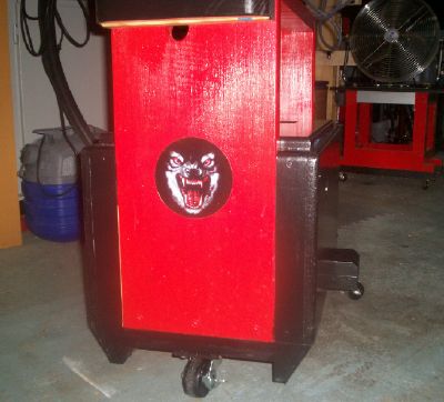

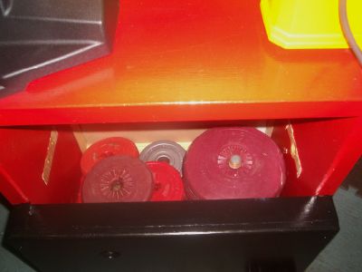

    Base of yellow pine with MDF side plates. Two 2 1/2" rear lock casters with a locking 4" front and the "tri-pod" is maintained. The rear of the belly tank has a 3/4" pipe mounted to a base flange with old 10 lb. weigh-lifting weights inserted on the vertical pipe. The base weights around 22 pounds with 60 lb. of weight added for stability. The DW weights approximately 50 lbs. for a total of a 130 pound unit that will not vibrate as tested.
    Will remove the additional forward weights Mon. and place a Genie vacuum in the front of the rear weights as I did with my old 16" SS. Port it out with a pipe just under the blade opening and "dust be gone"..
    Sorry for the bright, yellow glare of the DW colors which are were "hot" under my shop lights to-nite. Hot in hot-Lanta today and it's time to hit the showers.
    So... can you eliminate vibration and still go mobile? Yes... indeedy! Hopefully someone might catch an idea from the pics.

    That's a very cool base there, Sarge. I like the wolf snarling at me, but I'm a little surprised that you didn't match the DeWalt yellow for the base color.
    That's also a good way to use those weights. Right now I keep mine out to attract dust and to remind me that I used to be able to lift things that would hurt me now.
      Evenig bthere...
      It's the old base from the Ryobi 16" that was red and blue. I modified the base to get the tri-pod and slapped a coat of black porch and floor over the blue.
      I have the DW yellow.. but yellow over blue is a double coat to cover and it was hot down in L'ville as up the road in Alpharetta as you know. And the bottom line is too much yellow is just... well.... to much yellow.
